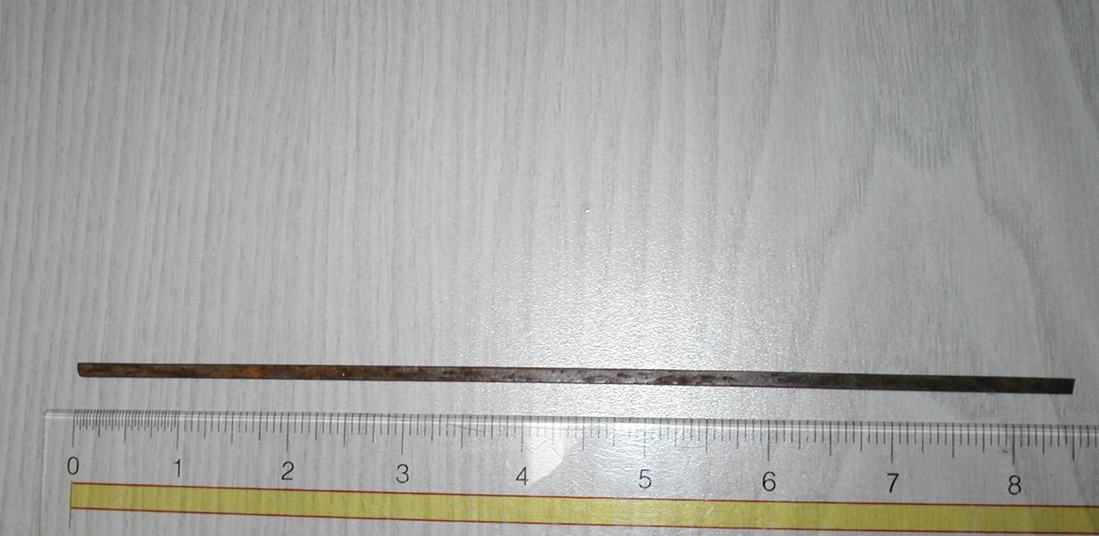

I was on my way to work yesterday and saw a team of 3 street sweepers, so I decided to go back today to where they were driving around. A five minute walk down the sidewalk yielded this laying on the side of the street:

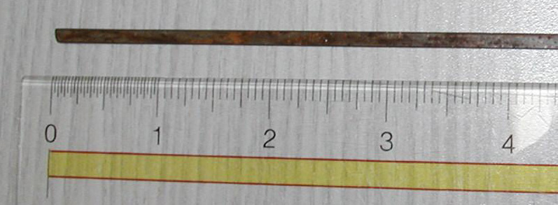

here's a view of the width:

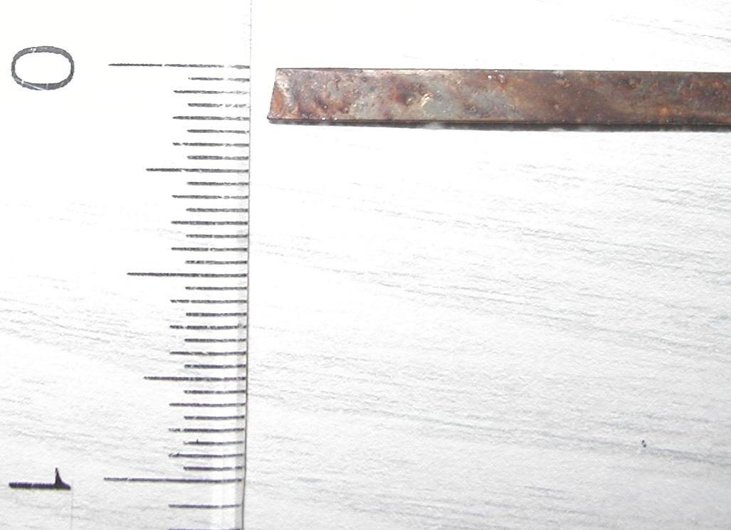

It is 1/8 inch wide and it is just under 1/32 inch thick (it fits between the smallest lines on my ruler and you can still see the lines), and my question is..
A. is this really a street sweeper bristle
B. is 8.5 inches long enough to make 2 Bogota rakes with straight handles?
the 8.5 inches is flexible; when I grab the ends I can bend an nice arc, but bending just an inch from the end is suprisingly difficult.
Is this size (1/8 inch wide by 1/32 thick) the standard size Bogota Rakes are usually made with?
Thank you,

squelchtone wrote:. . . is this really a street sweeper bristle?
That is a street sweeper bristle, and looks to be the usual width and thickness. Unfortunately, I can't answer the second part of your question: I'm not sure of the exact length required to make a pair of "standard" Bogotas... but I'm sure there's some considerable leeway, depending on how long you'd like the handles to be.

A. Yes
B. This is about the same length as the one I found. I cut it to 5 inches and made a double-ended pick out of it. A Bogota rake on one end and a short hook on the other. The only thing I don't like about it is it's difficult to hold on to while using.

Yes that is a sweeper bristle, but I don't think it came from those sweepers you saw, it seems to have lain in the gutter for a while and developed rust pits. Rust is not uncommon on bristle, but pits can be weakening the metal, so that would not be the first bristle i would reach for unless its the only one around, but in fact, those sweepers did shed bristles if the curb brush was in use, and you can find them by bicycleing along the route, looking for exactly the shape you found, but they will be grey if the were just dropped, that is a color that is closer to the pavement color, and perhaps a bit harder to spot, while rust is dark and easily shows up. I suggest that you go back and bike a few blocks with an eye on the ground where the gutters are really clean from the sweepers, you should find some newer stuff that hasn't been laying around rusting as long. neverthe less, you can make a pick from the piece you found, strip off as much rust as you can with scotchbrite material of the hardest kind, you may find some of the industrial grade scotchbrite at an auto body shop. they will throw out pieces still very good for this job.

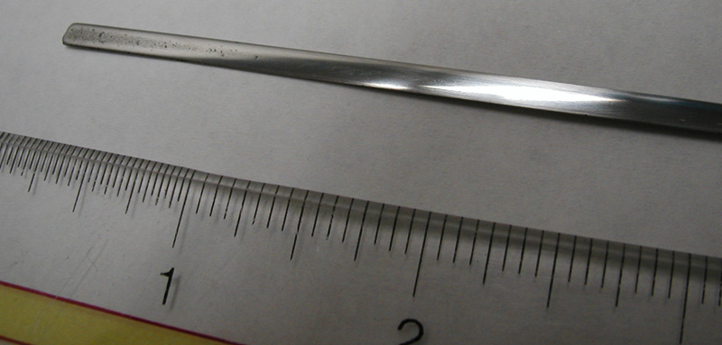

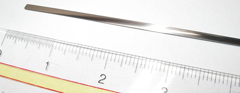

Postby Squelchtone » 29 Jul 2006 2:52
Just wanted to share some of my progress with the rusty pitted sweeper bristle.
Here's how I found her
Here's after about 3 minutes each with 320,400,600,800, and 1000 grit wet sanding:
That pitting at the end is where I held with my finger while moving the sand paper back and fourth, it was just as bad on the shiny part, so it will come off. I also noticed the tang is rounding on the edges which looks really slick
Here's a slightly different angle:
Looks nice so far, in the morning I'll do the entire bristle, tonight was just a test of the papers I bought. Maybe I'll get some 1200 and 2000 tomorrow.

Postby cL4y » 30 Jul 2006 2:37
kickass.
its amazing with a bit of work,you can make it shine in the mornin' light.
Hope it goes well :D
