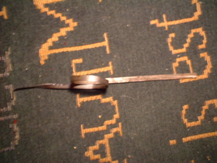

Postby illusion » 24 Jul 2006 17:49
Here are an example of the one I made. Made from street sweeper bristle, bent without heat. :)
I made them smoother recently with sandpaper, and files. :wink:

Postby illusion » 24 Jul 2006 17:58
the longer the wrench, the less torque is transfered into the rotation of the plug
Wrong, the mere fact it's longer means it will apply more turning force to the plug, hence contradicting the prupose of a feather wrench, don't you think? :)
There is a reason the loop is close to the end of the wrench. :)

Postby Shrub » 24 Jul 2006 19:16
Yes the further away the turning force is excerted to the plug the more movement would be required to move the plug the same distance if the turning force was close to the plug,
However,
The further away the turning force from the plug the more torque is excerted on the plug,
The more torque used on somthing the less feel there is,
A twist wrench or feather wrench is usually longer because to counter act the springyness it needs to be longer to excert the same pressure if so needed but the twist, spring or in illusions example the loop needs to be as near to the foot of the wrench as possable,
