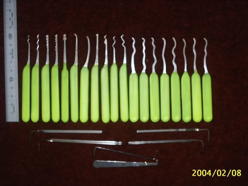

here's a photo of my steak knife picks, and a set of computer picks, also made from the same knives, which seem to work quite well for me. the handles were made from plasti-dip (thanks SLYFFER) ideal for the job.

Postby scampdog » 13 Sep 2006 18:59
these are the picks ready to go, made the case from an old leather passport holder.

Postby Bud Wiser » 13 Sep 2006 23:12
scampdog wrote:these are the picks ready to go, made the case from an old leather passport holder.
http://i39.photobucket.com/albums/e157/ ... ndcase.jpg
VERY NICE INDEED!
How did you make the handles, what did you use? Thx for sharing!

Postby scampdog » 14 Sep 2006 6:01
as i said earlier, the handles are made from Plasti-Dip, you just dip them in and leave them to harden, i used three coats.
