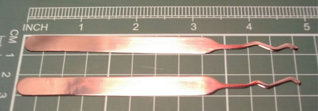

I have been asked a lot about the king and queen picks, so while I was making a set I thought I would take the time to snap a few pictures and put them here. There will be a few posts because I am taking breaks between the stages.
This particular set is in stainless steel, and will be finished with sealed cork handles.
Here is the first step.

Postby Romstar » 10 Nov 2006 2:25
Bear in mind that those picks are not polished yet. Thats the next step before preping for the handles.

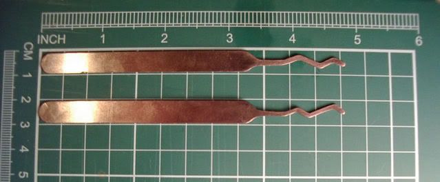

Postby Romstar » 10 Nov 2006 4:09
Okay, so here is first stage polishing, getting ready for the handles. Sorry about the glare, I am in the shop and I just don't have the lighting to get a really good image here.
There will be one more polishing run before they are done.

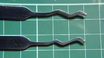

The next pictures are the second polishing before the handles are bonded to the picks. The trick here is that you can't have them too perfect otherwise the bonding agent has nothing to grab onto. So, they are close to mirrors but not quite.
This is a close up of the tips of the picks.
If you look closely, you can actually see my hand and the camera reflected in the picks.
The next set of shots will show the raw cork handles bonded to the picks before they are sealed.
