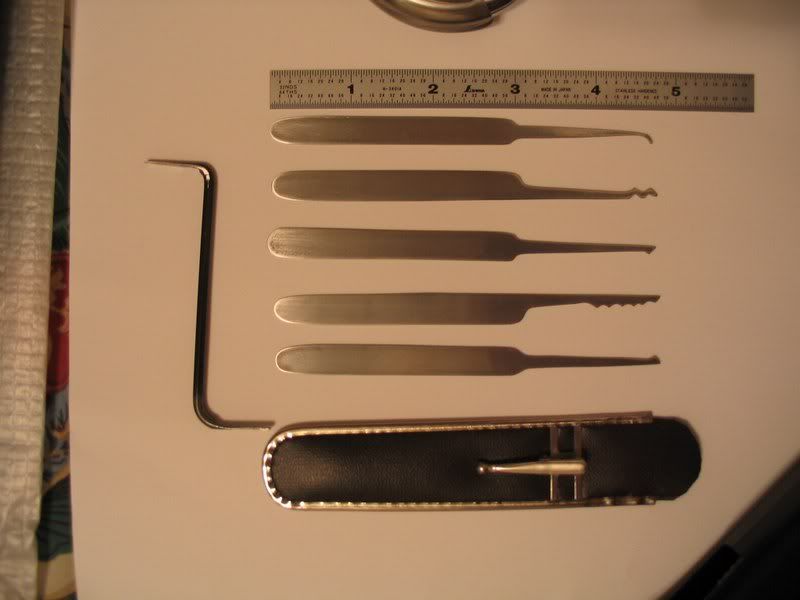

I just made these picks and case.
The picks are made from heat treated spring steel, hardened to 45 rockwell. This steel is great for picks, but very hard to cut, and grind!
http://i139.photobucket.com/albums/q296 ... ickset.jpg

Postby dmux » 21 Nov 2006 23:11
yea but in the long run they will be worth it, just hopefully they don't grind the pins down being such a hard steel

Postby Romstar » 21 Nov 2006 23:50
Polish the crap out of them, and they won't grind the pins that much.
Try to be sure there are no sharp edges anywhere on the picks.
Look at Raimundo's Bogota picks as an example.

Postby gostone » 22 Nov 2006 0:08
They are well polished, by hand, no sharp edges anywhere. Just need to go over them with crocus cloth ( Jewellers Rouge )

Postby gostone » 22 Nov 2006 18:37
I made a set out of hacksaw blades, they were effective, but I was not impressed with the steel. So I decided to make them out of hardened spring steel. It is a much better material than using the hacksaw blades. The only downside is that it is very hard to shape hardened spring steel as easily as a cheap high carbon steel.
At to the damaging of pins, as long as any tools you use are well polished there are no problems. By their very nature, lockpicks need to be hard to keep their shape. Otherwise we would be using brass lock picks!
