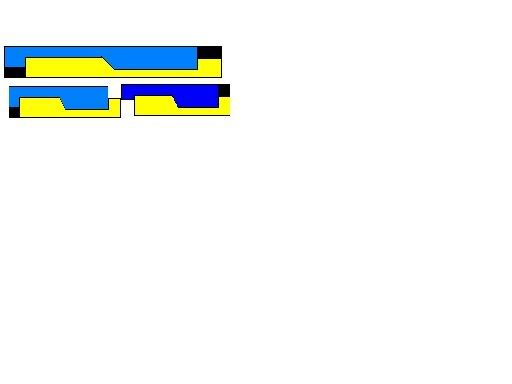

ok, I know that alot of us are using 1/2" steel stock to make our picks. I used to just cut it on both sides and make a pick, grinding away the material from both sides to make the business end. I started playing around with how to make more picks out of my investment in my stock and came up with a simple repeating pattern. Bear in mind that I am not an artist on paint, and that this is just a rough template but check this out.
As you can see, if you look at the top, by offsetting the two picks on top of one another, you can actually stack these one behind another to have almost no wasted metal. This way I got 12 picks out of 2' of material where as I would have usually gotten 6. This gives you a nice thick handle, a good business end, and tons of picks out of a lot less material. I use a dremel cut off wheel to split the two blanks, and then finish them into whatever picks I am wanting at the time. I still have to grind from both sides to make a few picks, but most can be made from this design with no problem. If someone is good at autocad and could make an accurate sized templates for everyone that would be great. Once again, this is just a rough drawing, but it should give everyone the idea. It repeats itself like the fish to bird drawing, meaning no wasted space.[/url]

I used to use the diagonal line about 1/3 bottome to 1/3 top. I just find that this makes a nice hadle, and with the dremel set at about 6,500 rpm unstead of the 10,000 for hi speed that I can neatly make these cuts in about 45 seconds or so per set of 2. There is no over heathing as I dip about after every straight cut, and they turn out very reliable, generic pick blanks, that when you have about 10-15 of them makes running through a complete set of picks a very easy process. Ray, you have that jewlers background, and you have ALOT of know how on how to make GREAT looking picks, but alot of us don't have your skill/knowlege and so this is a pretty easy method for those of us who aren't way past the commercial level pickmaker that you are.!!!  This should help out some people I hope, like me who first started making picks out of banged out clothes hanger to slowly progressing to some pretty decent metal work. Some day I hope to have a name like yours on here,lol... Until then I will continue to learn.

great idea guys i think i shall do this a few picks over. But dont you get weird ||||||____^ picks like my "image"? instead of nice ||||||------^?, which I think look a little nicer.
