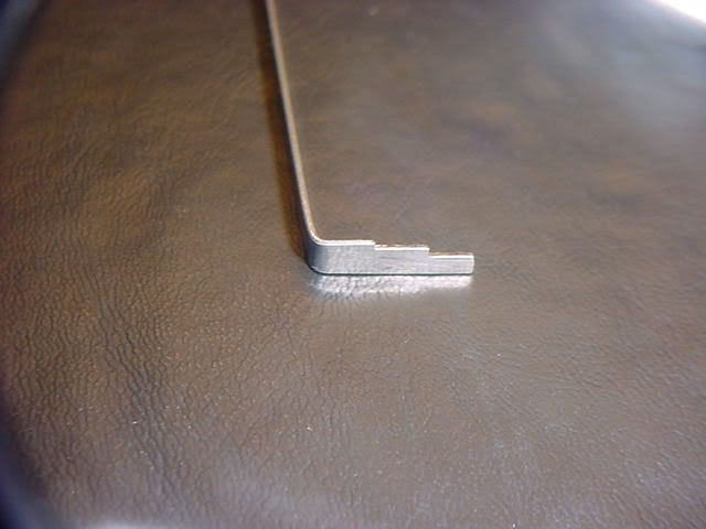

by Kaotik » 20 Jun 2007 17:47
I have taken a picture of the one I made that I thought Raymond was talking about.
I could be wrong, but that is what I pictured when I read the original post.

by Raymond » 20 Jun 2007 23:21
My thanks to Kaotik for the picture. I haven't quite yet figured how to post the picture. The tool he posted has two steps to my one but that is just as useful.

by robert11 » 23 Jun 2007 7:16
Sorry Raccoon,
By mistake I just mentioned your name instead of Raymond. Apologizing for my mistake
Hi Raymond,
As I wrote before for pictures - and now with the help of pics your description will much more helpful - Thanks to Kaotik for pics
