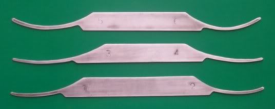

I’ve been thinking about the Falle Safe long curve picks since I first heard of Falle Safe here a couple of months ago. From the looks of the picks, I figured they would just be too big to fit in most keyways and would be pretty useless. But this guy Falle, seems to be well respected so maybe he had something I was missing.
So I’ve been wondering if these picks were all hype or actually any good. But, I wasn’t about to spend $280 US for a set of picks to find out. So last week I made some copies of his picks. All I had to work from was photos from Matt Blaze’s Crypto site.
These, of course, aren’t exactly like the originals. I don’t know what metal are used in the Falle’s or how thick they are. I made mine from a port-a-band band saw blade which is a tiny bit more “springy” than most of the picks I own and .020” thick. My picks surely aren’t as smooth as the originals but I think I got the shape pretty close. I figure they’re probably close enough to see if they’re all hype or not.
I’ve only had them for a few days but I’m already impressed and surprised. I haven’t found much use for the #5 and #6 which are the most aggressive curves but #’s 1 thru 4 have been great. They fit in most keyways okay and the feed back is impressive. By prying these things against the bottom of the keyway, you have a lot more control than you can get with a regular hook and you can really feel what’s happening with each pin.
I’ve been playing with a Master 911 with spool pins for awhile and I can finally really feel what I’m doing. I’ve been able to open the 911 with only 3 pins pretty consistently but it’s just become 10x easier and that’s all because of the excellent feedback I get from these picks.
So, I give the Falle’s a surprising A+…even my crappy copies of the real thing.
The only down side I can see is that, being double ended, they don’ fit in with the rest of my picks, I’ll have to find another place to store these.

Nice job - even got the numbers :-)
I'm a fan of the sweep or deep-curve picks too, as are several others on the board. It seems unlikely, but they work for all but the nastiest keyings where you have a really high setting pin behind a really low setting pin.
They really shine for setting spools - you have total control.
Mine are DIY too and I've continued to refine them as I use them - smoothing them out, thinning them down, rounding the edges. The real picks have very, very narrow blades (not the thickness of the steel but the depth of the curve) which could get delicate, so mine are all a hair wide. It hasn't been a problem.

at full depth in the keyway, the fulcrum is the center of the curve somewhere near the front of the keyway, as you work the pins closer to the front of the keyway, the fulcrum point is that part of the curve that still remains in the keyway at the point where the pickshaft emerges from the keyway,
it is these closer to the front pins, where you start to lose the fulcrum that yo can use the deepest curves on.
personally, I would design a curve weighted to picking high pins behind deep pins in the back of the lock, this would put more of the curve toward the tip of the pick.

Southern Specialties makes a second Falle clone set that does exactly that. But it's kinda hard to get the tool in the lock sometimes.

raimundo wrote:....personally, I would design a curve weighted to picking high pins behind deep pins in the back of the lock, this would put more of the curve toward the tip of the pick.
I think they call that a hook :wink:
