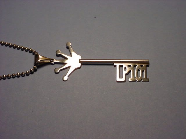

Nah, that'd be if you turned Kaotik's awesome LP101 Key into a big pendant, but that'd be a desecration...

Dragunov-21 wrote:Nah, that'd be if you turned Kaotik's awesome LP101 Key into a big pendant, but that'd be a desecration...
I don't think it would be a desecration. :wink:
I even made one as you can see above just for that reason. The proud owner is pretty fond of it to. Ain't that right d_b?! :)

Goddamn you Kaotik...
Bling is supposed to be tacky as craft glue, and then you do something like that... :evil:

Postby Trip Doctor » 11 Oct 2007 18:01
I think I can see part of a fingerprint in the "101", lol.
You gotta wipe it with your shirt and not touch it before you take a picture ! :P

Kaotik wrote:The proud owner is pretty fond of it to. Ain't that right d_b?! :)
Indeed. It hangs proudly from the review mirror on my car. A beautiful piece of work.
Mind you... I'm not so keen on attention being drawn to it again. As much as I'm a BIG fan of Kaotik's work... I kinda like the fact that there aren't a whole bunch of these floating around. Kinda makes mine... special. :)
