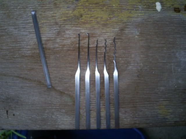

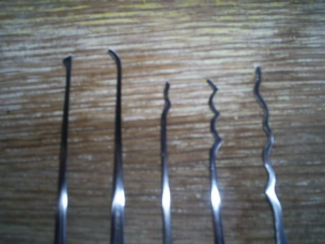

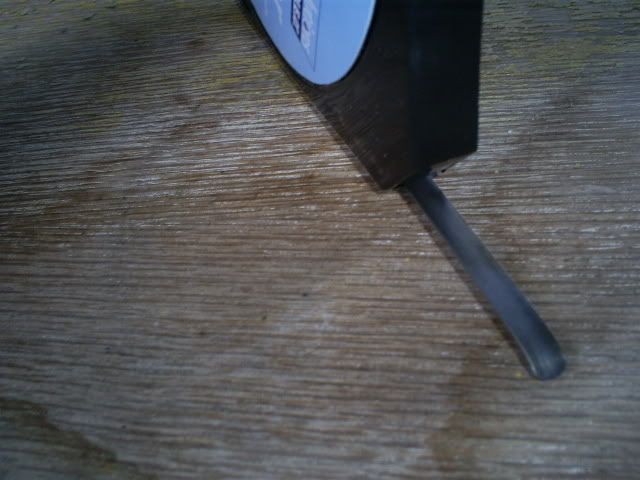

Postby Brianpojo56 » 11 Jul 2008 18:58
Okay, I got pics of my sink cleaner (mini plumber snake thing) and some picks I made out of it.
Sink Cleaner by Peerless (available at Walmart)
Flat Steel (it comes with a short coil at the end for grabbing gunk)
Set of picks next to a piece a bare piece of the material
Close up on picks
The flat steel is a 0.25 inches wide and is 0.032 inches thick, after forming the picks and some good sanding it came out to 0.025 inches thick. Oh and it was $4.95 and it's got 20 feet. Only problem I had is the slight curve it has because it comes in a roll, but you can slowly bend out the curve and make it flat.
