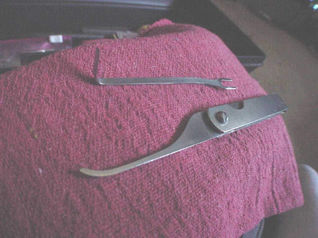

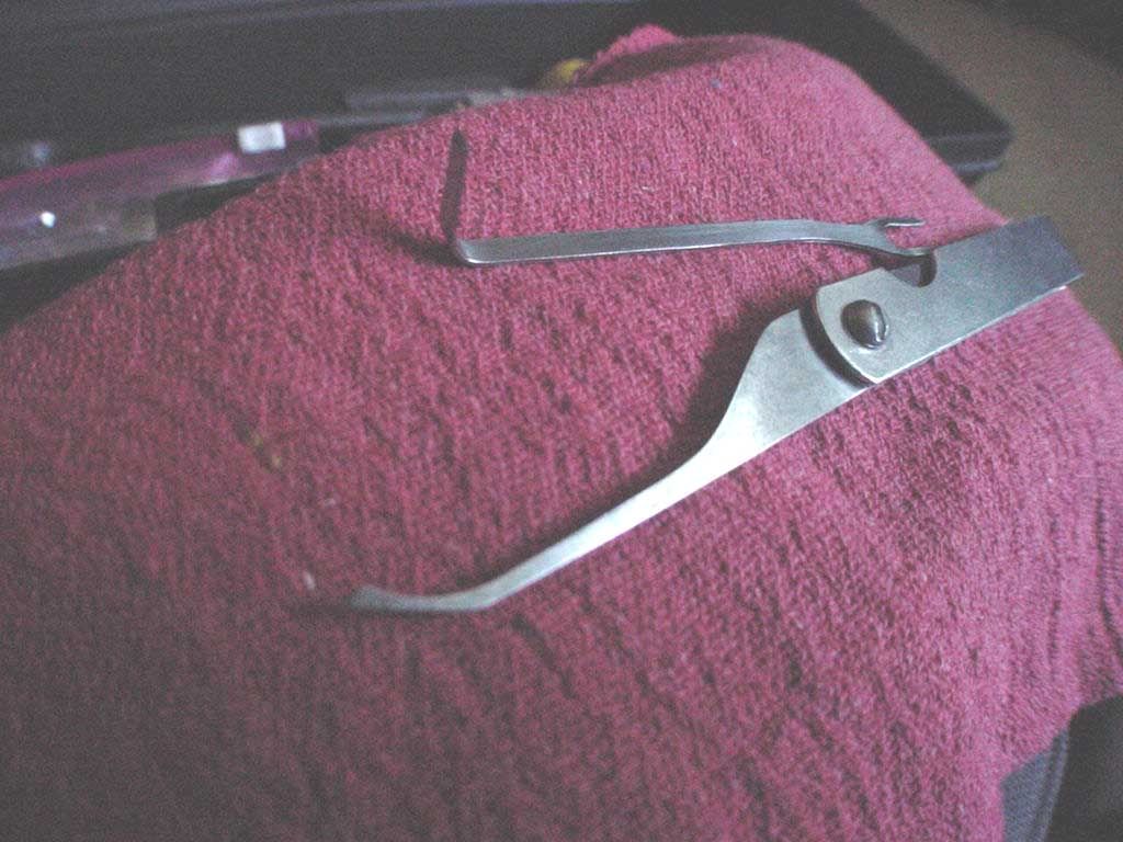

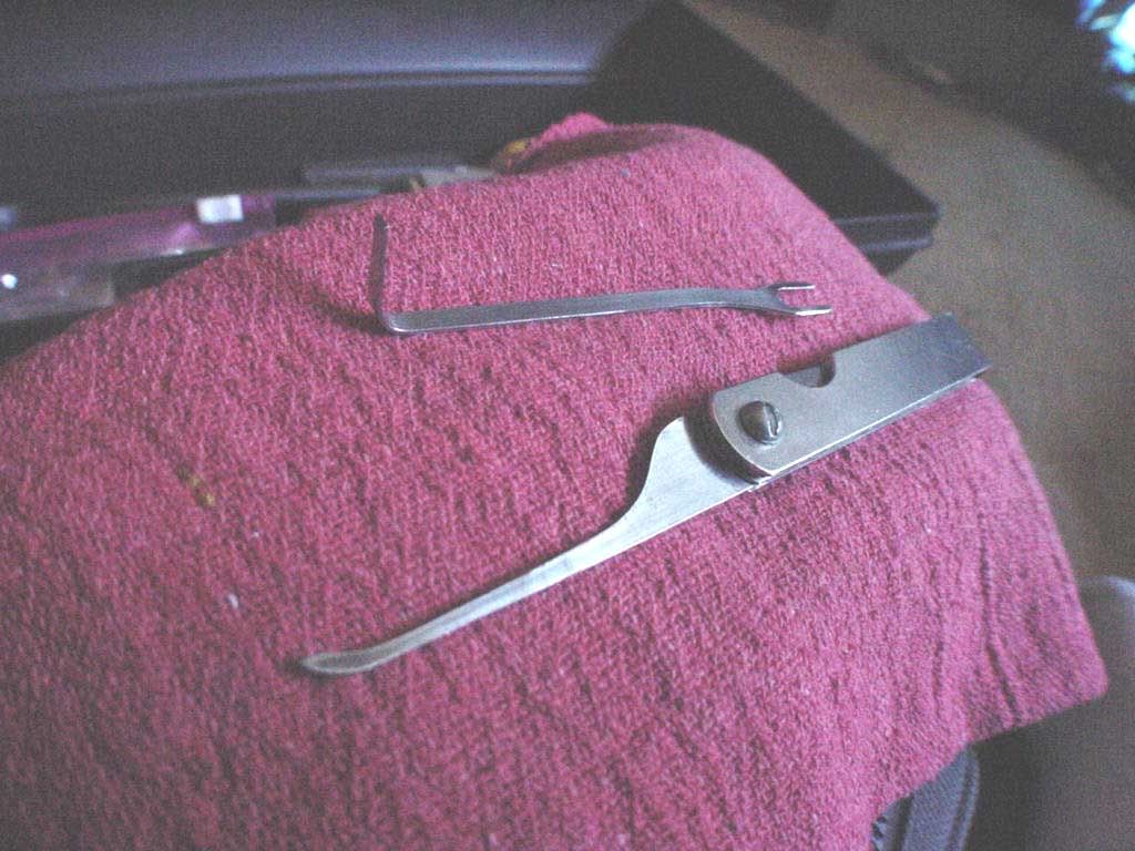

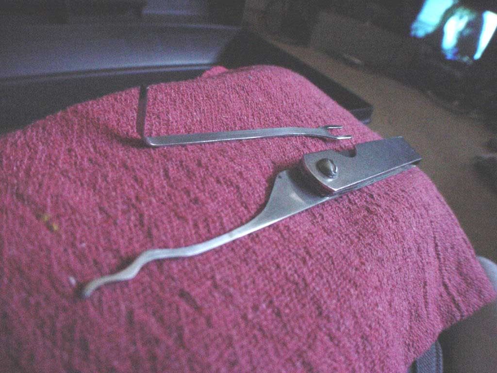

I borrowed a digital camera for about five minutes and took some pics of my feeler guage set!
I also have a half diamond that I lost the pic of, sorry guys. :( I like half diamonds, but that particular one came out badly. I will make a new one in the future, anyway...
I don't use that tension tool much anymore, but I made it to go with the set. The forked end fits under the nut of the holder to keep it all in one. After making this tool, I realized that in the spirit of being multi-use/multi-purpose I could bend the forked end and have a 2-prong tension tool at one end and standard or twist-flex on the other! The 2-pron end could even still secure the tool to the rest of the set! If I ever get around to doing that, I will have to take more pictures. :D
This, of course is a rake... It is rather large, but I have opened a few locks with it. :) I don't use it all that often. Just for fun! :)
Here's a short hook. This thing works pretty well for me on BEST padlocks.
Here's one of my favorites lately! I use this one for almost everything! Works really well for neutralizing spool pins on American Brand, and ABUS locks with keyways that I am more familiar with. If I had to carry only a single pic with me, this would probably be it.. The tip is slightly rounded on the edges, and flat on the top, but I like to experiment with the angle of the flat part sometimes. (This wasn't one of those times, hehe)
Note: when using a tall hook on American brand or anything similar, I like to put the tension tool at the top of the keyway. Some people do not like larger hooks because of the way that they fit into the lock. Things can get a little cramped, but they work well for me on security pins as long as I can get them in the lock. Where there is trouble getting to the back pins, a pick more like the peterson reach may be the best. I made a similar shape but I made it too thin.. soory, no pics of that one.. it broke. I know what to do next time I make one though! (Worked well, btw)
For Those nasty ABUS keyways I like to use this deforest-like tip for wedging the back pins up! Then I may go in with a tall hook or just continue with the deforest if it feels right! :) A "reach" shaped tool works as well, but the point on the tip can be used as a wedge. A half diamond may also work this way on a hard to get back pin that sets really low. Just gotta
get the right tension. ;)
