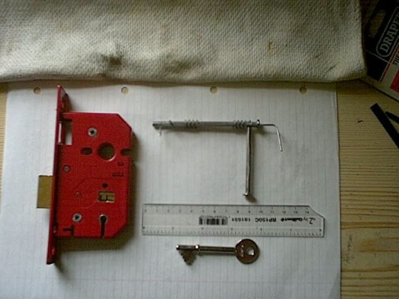

Hi all. Just wanted to share my latest lock pick. It is for a curtain lever lock. You can find some photos here, the photo is a little blurred :oops: , but the ruler is in cm on top and inches below.
the parts

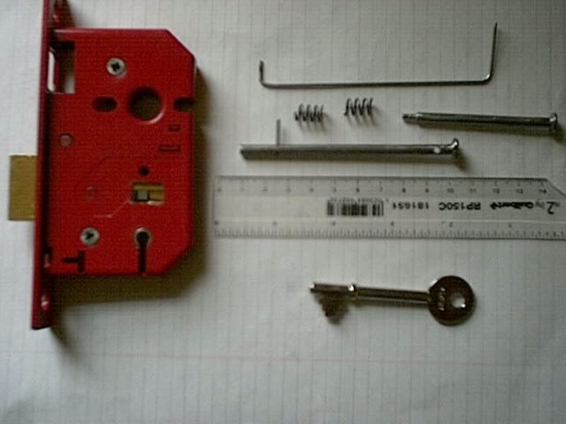

Constructed
http://img.photobucket.com/albums/v441/jimmythelock/Curtainpick2.jpg

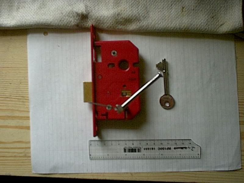

http://img.photobucket.com/albums/v441/jimmythelock/Curtainpick3.jpgIN In action

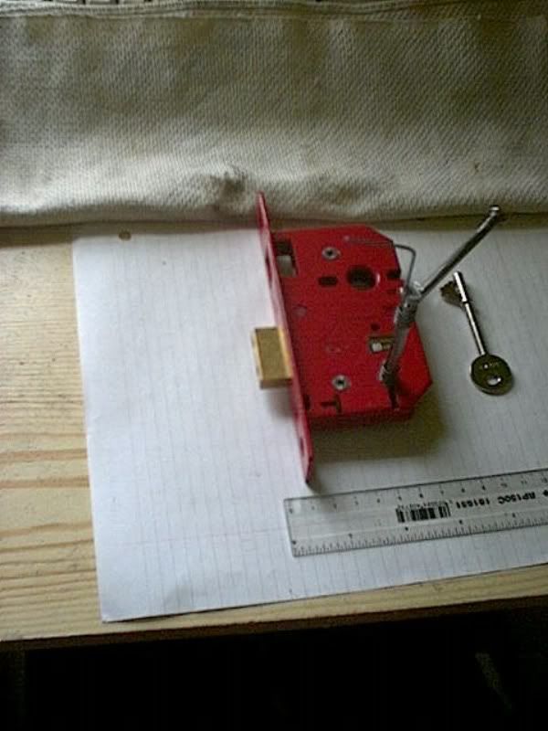

http://img.photobucket.com/albums/v441/jimmythelock/Curtainpick4.jpg

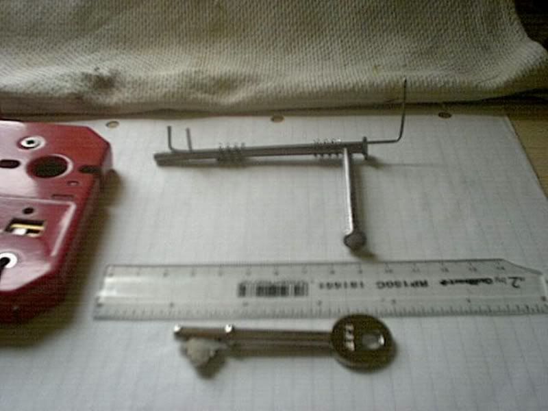

http://img.photobucket.com/albums/v441/jimmythelock/Curtainpick5.jpg
It is basically made from two 10cm steel nails for the main shaft and torque handle, with a piece of modelling steel for the lever lifter(from a model railway shop, 1mm diameter). I have used a spring cut in two to keep the lifter in some grooves I have cut down the length of the nail to allow for a smooth turning motion. There are also grooves cut in the head of the nail to hold the lifter more tightly.
I have had some great success on my era viscount (yes I know this is a basic 5-lever but I need to start off slowly). From the photos you can see I have cut a small window to see what the levers are doing. I will be moving on to other locks after a few modifications. They are:
1. I made the lifter thin enough to lift just one lever, that was bad. I turns out that the slant on all the levers give such a large contact area with the stump that it takes soooooo long to get the stump to move anywhere. So I have made a lifter that will lift several adjacent levers to speed things up a bit.
2. The stump that I have is an old toughened steel drill bit. It bends quite alot in spite of its strength. I want to modify the pick so I can interchange them allowing for breakages, bending and different keyhole sizes.
