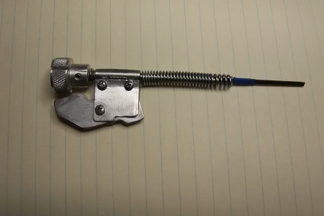

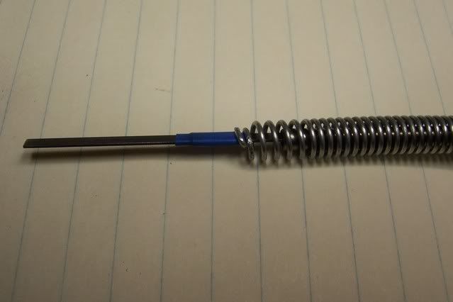

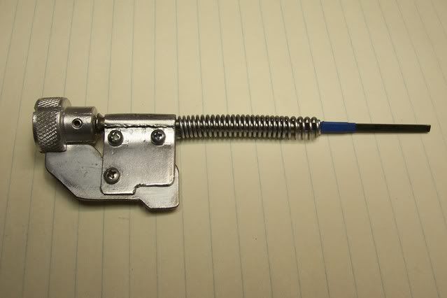

Check out this plug spinner. It isn’t finished too well because I was in a hurry to get it working. My other one broke and I was feeling desperate. The spring is just crimped on the street sweeper brush on one end and secured by one screw on the other end between the body plates. The blue heat shrink is to keep the shaft from backing out through the spring crimp. The body is some thin stainless strips I found. I bent it around a tube and secured it with the screws. The knob was slotted with a hacksaw and file. After turning to load the spin, the back of the trigger moves into the slots on the knob. If the shaft ever breaks, I will just put another one into the knob and slide it into the tube and spring.

Postby ToolyMcgee » 24 Aug 2008 2:47
Wow, that's f'ing awesome!
Makes my mouse trap DIY look like crap. I spent a whole afternoon trying to think of a way to make it preloaded and trigger activated. The knob is the answer.
How did you make the tube grip the back of the bristle? I see a screw in the side of the knob that could be pressing the bristle to the other side of the interior of the knob, but the angle doesn't look right... where did you get the spring?
Great job. It looks as good as any pro plug spinner I have ever laid eyes on, even if it isn't finished to your liking.

Postby Raymond » 24 Aug 2008 20:31
Thanks for the replies. I hoope someone can benefit from the rough design and improve it. The street sweeper bristle is held into the knob by a piece of aluminul rod that I sawed a slot in. Then the set screws on the knob hold the rod in place and compress it to also hold onto the bristle. If it works this time here is the photo of the back.

Postby Raymond » 24 Aug 2008 22:47
I have no specifications on the spring. It is just one I found laying around my garage. My first homebrew spinner was very similar. On it I used a plastic knob from an electronics shop with the grooves cut into it. I soldered the bristle to the spring. The frame was aluminum and finally broke. This lasted about five years. I up graded it to an aluminum knob.
I am trying again to show the back of the plug spinner. Here is that elusive photo.
[img][img]http://i211.photobucket.com/albums/bb277/cookiebear7/PSback.jpg[/img][/img]

Postby Raymond » 28 Aug 2008 18:34
No, I did not weld anything in this model. The frame is folded around a tube and held in place by the screws. The back of the spring has a U shaped curve in it that hooks around the front screw inside the frame. I have never encountered a problem with damage to either the spinner or the lock being opened due to continued spinning. When I have spun some deadbolts, they spin around so far that the bolt snaps back without help from a screwdriver. By deliberate design, I prefer having the bristle loose on the tip and attached only at the rear. I feel this allows a certain amount of built in flex that prevents damage anywhere. The bristle can twist both in front of and behind the spring.
