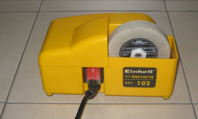

Postby femurat » 29 Sep 2008 8:53
When you're making picks from hacksaw blades or bristles you have to keep it cool when you grind/file it. At least not let it became too hot to avoid the steel to loose his temper. For this reason a great technique is to keep a glass of water near you to dump the pick into every few seconds of grinding.
And what if you use a wet grinder? You can find it at a very affordable price in some stores, usually sold for filing knifes.
The wet grinder has several benefits, first of all less speed of the wheel to avoid water to go everywhere. Less speed means less powder, less noise, and a LESS DANGEROUS tool!
And you don't need to quench your pick in water every 3 seconds, cause your pick will remain always fresh.
On the other side, I tried this new tool and i discovered that grinding is slower. Less speed of the grinder = less speed of the job.
For me this is a very good solution, hope this helps.

Postby MBI » 29 Sep 2008 10:31
A wet grinder is one of my top choices. I've had one for years for knife sharpening, for times when I have to regrind a blade and remove so much material that it would take hours if done by hand. On the rare occasion that I make lockpicks, it's what I like to use for rough shaping the pick before finishing up with hand files.

Postby femurat » 15 Oct 2008 2:27
Wet grinder + hand files are my favorite tools. Then some sand paper and you've done.
I have to admit that the wet grinder is not the best choice for hacksaw blades: they're too strong and grinding at a low speed could takes too much time. But if you use bristles or wiper blade inserts it's perfect!

Postby femurat » 27 Oct 2008 4:55
mine was 20/30 euro at LIDL :D

Re: wet grinder
Postby Jaakko » 3 Jan 2009 15:11
Usually wet grinders rotate very slowly, like a turn or few per second. They are intended for sharpening, not material removal.

Postby femurat » 6 Jan 2009 11:26
Hi ToolyMcgee, thanks for your good words :)
I love DIY. Building picks is very satisfying, especially when they work well!
On my wet grinder the wheel speed is 250 rpm. It's very slow because, as Jaakko said, it's intended for sharpening knives. It goes CCW and the water drops get caught by the upper side on the left, falling again in its container. A few drops of water may fall out of the grinder, but it's impossible to get wet. I use it on my kitchen top and there isn't water around after the grinding process. I think they set the wheel speed to avoid spraying water around.

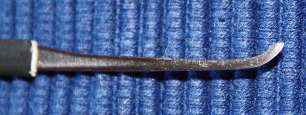

Postby femurat » 12 Jan 2009 10:22
This is a hook I recently made with my wet grinder, a few touches of needle file and a lot of sand paper.
Huge picture warning: I was so proud of it that I made a 1600px wide picture...
It looked shining and smooth, but now that I've seen it so big I think I must give it another touch of polish...
It works very well: the shaft is strong and gives a good feedback, the tip is long enough to raise the lowest pins and short enough to pass over the longest ones.
I think I've found my ideal hook shape, I just wanted to share this :)
