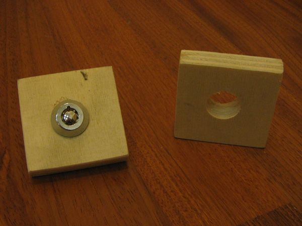

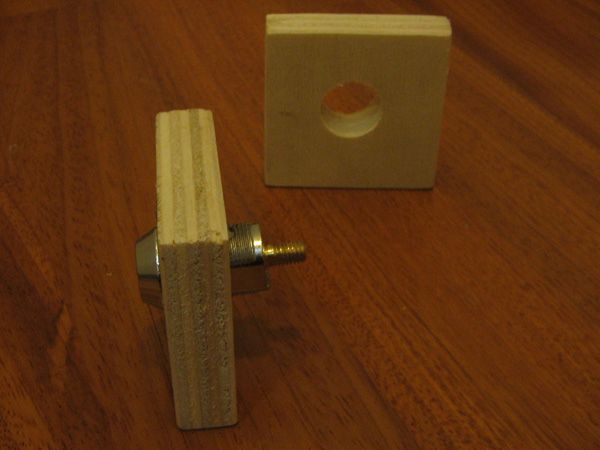

Postby datagram » 7 Nov 2008 14:58
That's pretty much the idea. Just take a piece of wood thick enough for whatever you want to put in it, and mount the locks. Building a small base is also very helpful.
If you want to do something smaller you can build lock blocks to use for single cylinders. It is less realistic (for door picking) than the stand up board, but also easier to transport and easier to distribute if you want to pick with friends.

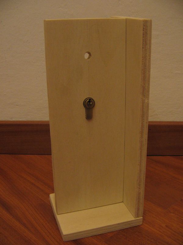

Postby femurat » 19 Nov 2008 5:31
Yesterday my friend with the saw hosted me for an hour... Here you can find the results.
In the upper hole I'll put a knob to have a more realistic model.
I also have to put a screw in the lock side hole to keep it in place.
When I got home I immediately tried it: I have to shorten my wrenches to rotate them without touching the frame.
The feedback is much more notable than holding the lock in my hand. I can also hear a click amplified by the wood when I set a pin.
I also made some little holders for "sofa-picking"
This is just my first try, I guess I can make an improved version following your upcoming comments...
Thanks to all :D

Postby Major Boothroyd » 26 Nov 2008 15:41
It looks good, not sure how you're going to screw the lock in place though. Keep working on it, looks like a great start.

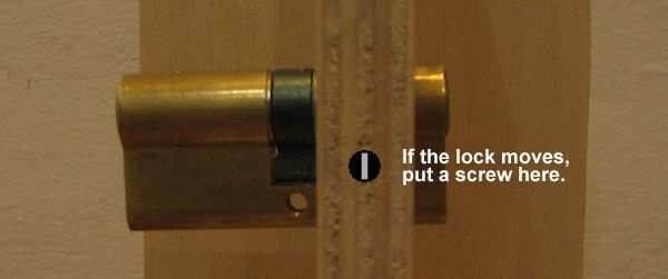

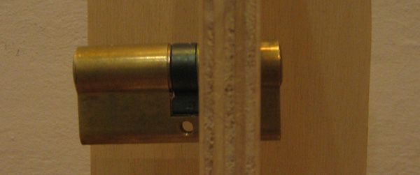

Postby femurat » 28 Nov 2008 9:12
Major Boothroyd wrote:It looks good, not sure how you're going to screw the lock in place though. Keep working on it, looks like a great start.
I thought I had to put a screw in the wood, from the bottom part of the T profile to the lock side, to keep it in place.
Fortunately the lock seems to stay firmly in place thanks to the friction with the hole. For now I can do without the screw: I made the hole with my dremel a little thinner than regular ones, exactly the same as the lock :)
I'm not sure I was clear, so this is a picture to show the point where I can put a screw to increase the friction and hold the lock in place.
I'm glad you think this is a great start. This station looks like a door model. It's a lot different from my initial idea. I wanted a station to organize all my picks and locks but I realized this was not an easy task, so I decided to start with something easier. Maybe in the future I can come up with some new idea... for now this works good. Cheers :)
