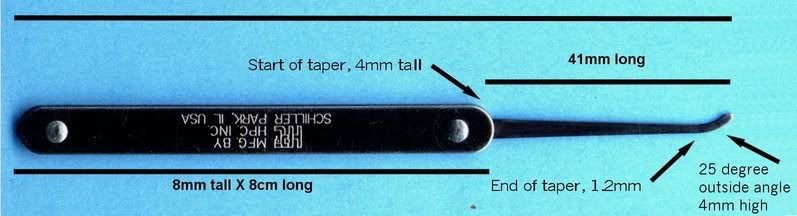

I know I posted material about this a while back, but for the life of me I can't find the post.
Lets take an HPC medium lifter pick as an example.
The entire pick itself is 12.15 CM long, or exactly 4 and 3/4 inches. It's handle is 8mm high, and 8cm long, or 5/16ths high, and 3 and 3/16ths long. The thickness is 1/32ths, or .7mm. This will be three times as thick if you include handles the same thickness as the pick.
Those are the easy measurements. Take a piece of .025" steel and cut, file or grind to 4 & 3/4 long by 5/16ths wide. This is your complete blank.
The pick tang or blade is 41mm long, or 1 & 5/8ths long.
The taper begins at 4mm or 1/8ths high. Over a length of 1 & 7/16ths or 3.8cm it tapers down to 1.2mm or 1/16ths of an inch. Measuring the height of the hook from the bottom of the tqaper, it's 4mm or 1/8th inch high.
The hook itself has a 25 degree radius along it's bottom edge.
These measurements are all a bit easier to understand if you have something to look at, so see the illustration below.
