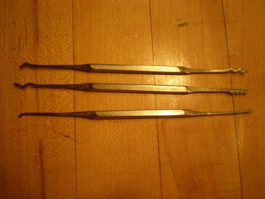

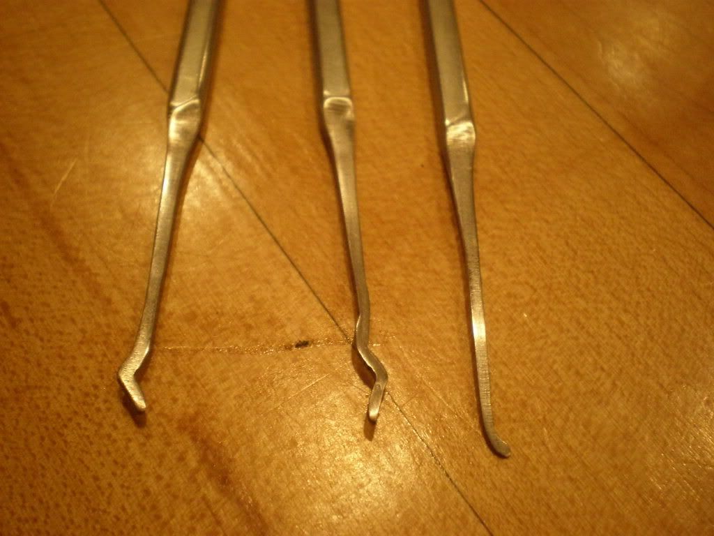

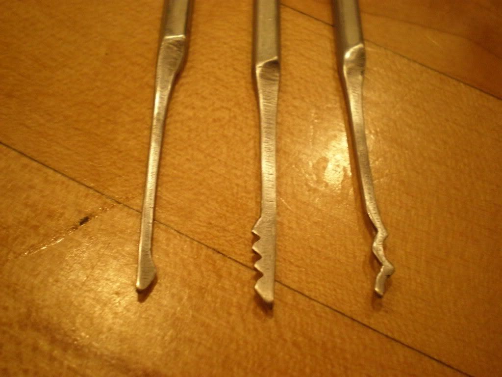

This weekend I decided I wanted to make some nice looking and working picks. I used the rod that string is wound around inside window blinds. They work way better than hacksaw blade set and are more responsive than my dx set. Tell me what you think.
I made a different pick like the hook and diamond one for my friend who just got into lock picking like me. He insists on paying me for it so how much do you think one of these picks is worth (if I finished sanding them).
I know they still need a little more sanding...

Postby TTXIII » 11 Apr 2009 23:12
Those look like a great start, with a little more sanding (as you suggested) I think they will make a beautiful pick set. I personally prefer a thinner material because I don't have to grind as much but I will have to give the window rod a try, where did you find some? Also what did you use to grind the metal? As for you friend I would say you average between materials cost and what you think is a reasonable amount for the time you put into it.

Postby jor2daje » 11 Apr 2009 23:28
I used a bench grinder, a dremel and a couple of files.

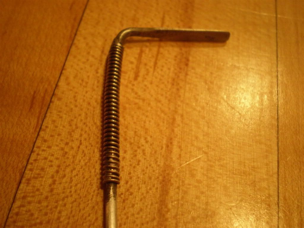

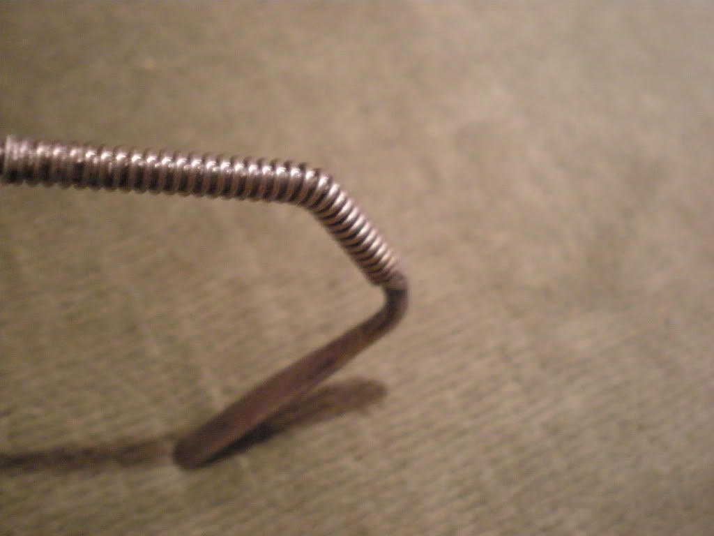

Forgot to put this in the original post but here's the tension wrench I made to go with this set. Its my attempt at a feather touch wrench, Its a bicycle spoke with a spring soldered to both pieces, I only heated the spoke so the temper of the spring is still ok as far as I can tell.

Postby Safety0ff » 11 Apr 2009 23:38
Way to be creative in finding materials, looks like you've got a nice set going there.
I don't understand the function of the spring on your feather touch tension wrench though, it looks like it simply goes around the spoke.

Postby jor2daje » 11 Apr 2009 23:47

Postby Safety0ff » 11 Apr 2009 23:58
Oh, so the spoke bends?!
(I know how they're supposed to work, I was enquiring about your specific wrench.)
thanks.

Postby jor2daje » 12 Apr 2009 0:25
Sorry shoulda been more specific, the pick is two pieces connected by the spring.

Re: My New Picks
Postby Safety0ff » 12 Apr 2009 1:10
Ah, I see it now. :)
It has a considerably shorter gap than others I've seen, but with that spring it makes sens.
Does it work well for you? I've heard mixed things about the feather touch tools.

Re: My New Picks
Postby jor2daje » 12 Apr 2009 2:33
works surprisingly well, it could just be that Im fairly new to lock picking, Ive picked all of my locks with this set. I think its a little easier with the feather touch wrench because I can focus more on setting pins than what tension to apply.

Postby Engineer » 12 Apr 2009 17:17
That is some nice work - Well done!

Postby jamesphilhulk2 » 12 Apr 2009 17:39
should be a nice set once its fine sanded and polished, how thick are they

Postby tballard » 15 Apr 2009 11:25
Very nice tools, especially considering they are an "early" effort. Might I suggest that if your friend insists on compensating you, an interesting lock or two is probably more worthwhile and equitable than money. I make a lot of tools, and even the simple ones often take multiple hours.
What's your time worth? Even at minimum wage, you'd be looking at 15-20 bucks a pick if you were being paid as though this was "just a job", and a skilled craftsman would command a much higher price. Fortunately, we do this for fun, not profit, because few people would be able to afford handmade picks. For fun and inspiration, look at some of the picks Raytoke produces. I don't think anyone will disagree that his work is orders of magnitude beyond most picks, including pricey factory made "real" tools. I can't/won't comment on his prices specifically, but I know how much a few of his picks went for, and they were shockingly affordable. The only reason mortals can afford picks like these is because the makers are doing it for fun and basically giving them away.
What I'm getting at is that any sort of "payment" is really more of a token of gratitude, and at best should be thought of as something to defray the overhead cost of your hobby or keep you interested (in the case of things like trading for locks).
Bottom line: have fun. If your friend feels the need to say "thank you" see if he'll express it with a donation of his own time. (Like hunting down and purchasing an interesting lock)

Postby femurat » 16 Apr 2009 3:56
It's interesting how we interpret shapes when we start out. Your picks are original, their tips are similar to commercial ones but have some unusual details... Well done! I'd like to see them again once sanded.
I do agree with tballard, a good lock is the best reward for a pickmaker.

Postby jerrasis » 17 Apr 2009 8:34
Those look great. How comfortable are the handles? I'm thinking of trying my hand at making one or two and I have small hands. Do you think that would make a difference??

Postby jor2daje » 17 Apr 2009 18:44
Im working on the polishing, sorta busy with school but getting a little done here and there.
The picks are really nice to work with, they feel a lot like a dentists tools and feedback is really good.
