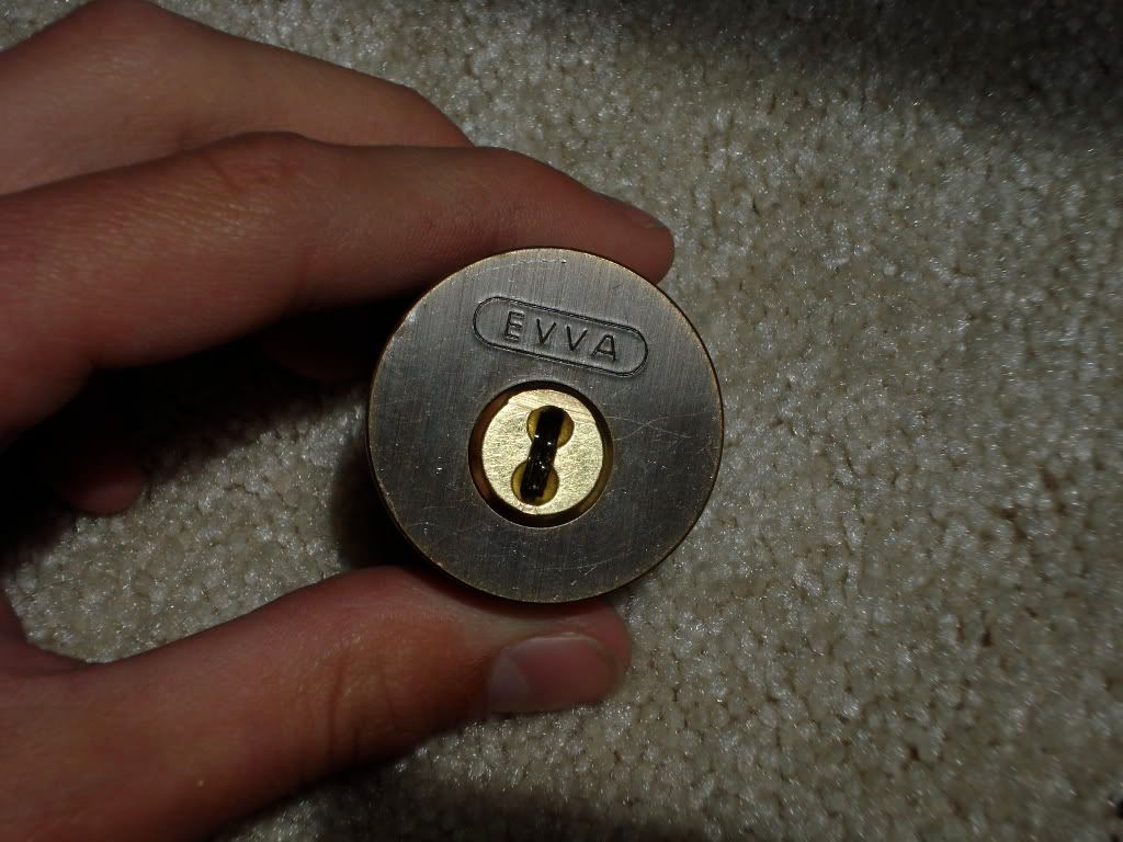

by Baloopaloop » 26 May 2009 17:49
Here are the first batch of bansaw picks I made yesterday, nothing too fancy but just what I need. The left side is for the evva 3ks, and the right side is for regular pin and tumbler locks. http://i613.photobucket.com/albums/tt21 ... C05629.jpg
