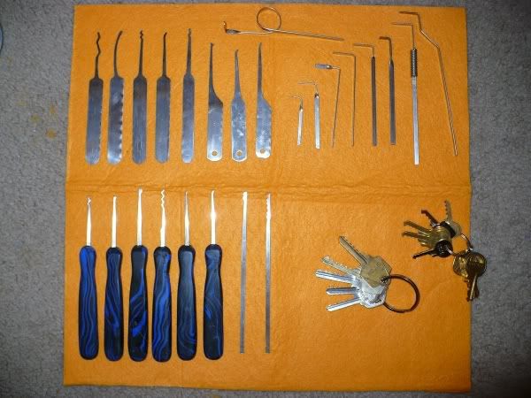

here are some picks iv made recently. they keep getting better and better. can you guess in which order i made them?

Excellent looking picks man. Those clay handles are fantastic! A city rake and spring tensioners too... that's some advanced stuff.

Very Well Done. How Does The Clay Do With Feed-Back?

You made a very big set and choose the right picks. I like your handles too 8)

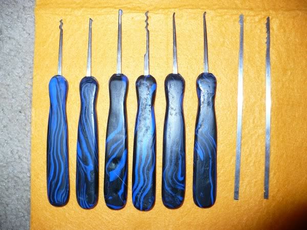

thanks fro the complements. the clay handles are made out of polymer clay, fimo to be specific. the feedback is very good in my opinion, the clay is very firm, although i don't have a commercial set to compare it to.

thank you Legion303, i don't know if you can tell but i got most of my ideas from you and your pick making tutorial. i did make some improvements to the mold making process and experimented with different release agents. i also shaped all my picks before putting handles on them.

I'll have to update the tutorial, but so far I've found the best release agent to be simple baby powder (talc) rubbed on the molds. I also shape the picks first these days...looks like you figured that out way faster than I did. :P

I've recently been trying to make handles with fimo and have had a hard time of it so far. You said you improved upon Legion's mold making process...I would be very interested in hearing about the improvements you made as I have had quite limited success with the whole process to this point.

nice looking picks, what are you using to shape them? Are you working with files or a dremmel, or other?

i use the laser printer transfer method onto the wiper insert, then i cut it out with a dremmel, and finish it up with hand files and several grits of sandpaper. Thanks for all the good comments. and thanks for mentioning that raimundo i should have said what the bb's were for.

Do the FIMO handles hold together and wear well with extended use and carrying? Like abrasion resistance and dings?
Do the pick shafts ever tend to enlarge the 'hole' in the handle as they flex from side to side with use?
