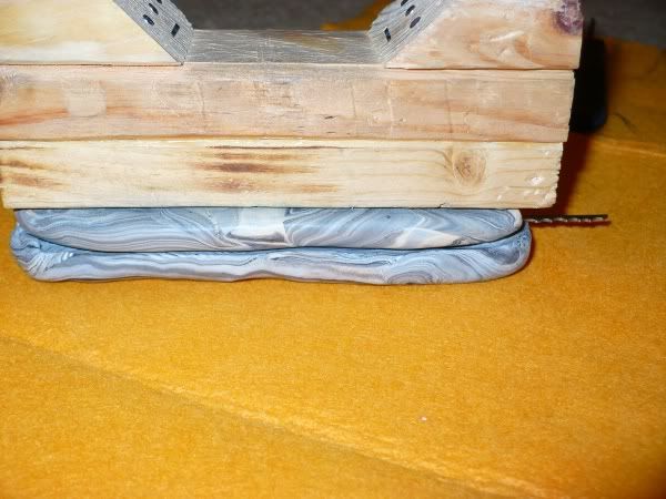

now i put this side in the oven for about 10 minutes(or until its somewhat stiffer and not sticky) i then put the halves back together with the pick inside. and placed it back in the oven with some sort of light weight on top and finished baking.
then i let it cool. and you should have something like this.
