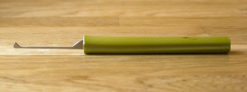

As I said during this discussion, I wished to make some bamboo handles but finding a bamboo plant was very difficult, and after a while I forgot about it.

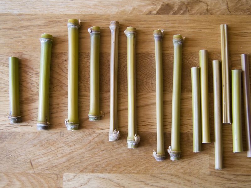

One day during a visit to a farm I found a small bamboo root so I potted it on my balcony. The plants grew up quickly and I enjoyed them for almost a year! About a month ago some small shoots started to grow from the ground, so I decided to cut two old plants out of three and got these beautiful bamboo handles.
Then I finished an half diamond that was laying around and shoved it into one of the bamboo handles. I choose a piece of bamboo with the groove a little smaller than the pick handle. I had to keep it from the tang with pliers and press hard while the bamboo was kept perpendicular to the working surface.
The pick is very tight, it has no play (for now) and gives a very good feedback. I tried it with success with: iseo R6, multilock 7x7, bricard and other dimple locks I like to pick. I use the twisting technique to lift the pins and this cylindrical handle is perfect for this purpose. And it's super light weight.

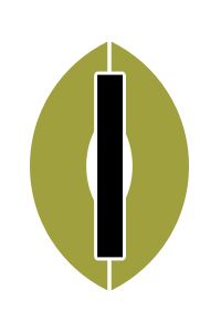

I know your approach Ray, and I admire you for it, but this time it'll be hard to go further. I made a quick draw of the pick section, is this that you have in mind?
I consider bamboo a good material because it's round, it's like the arc concept. If you split it I fear it'll loose its strength, but I'm just speculating. Maybe the epoxy used to fix the handle can keep together the bamboo fibres too...
A downside of splitting bamboo is the risk of ruin its "peel" so be careful when you cut.
A good thing about cutting bamboo and making a sandwich pick is that it's naturally carved, so it's easy to hide the metal handle of the pick inside the bamboo groove.

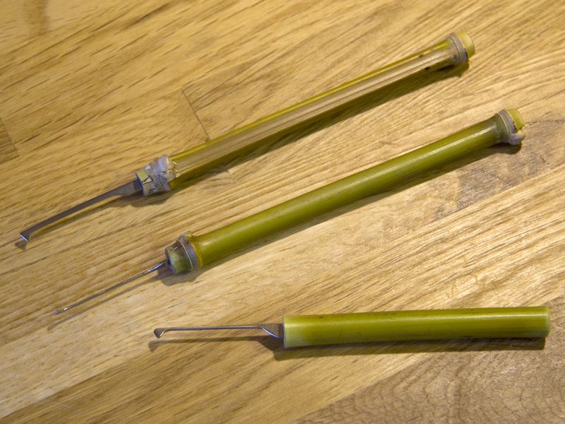

I made a couple of picks to try the bamboo handles with the knots. At the bottom of the picture you can see the old one.
I think that the knot can be useful to keep the pick in place for a long time. I just pushed hard a tapered bristle in with pliers to make the hole, then I put 2 drops of superglue on the pick and pushed it in till it stopped.
As you can see the knot is exactly where you put your fingers to hold the pick. I made it this way to get a more ergonomic handle but I'm not sure about the result since I haven't tested it yet (immediately after I make a pick my fingers are so tired that I just try if it can work, but I'm unable to feel how well it works).
One more thing to mention is that I made the first pick with a wiper blade insert, and these last 2 with bristles. Since the wiper insert is bigger its handle is bigger and is much more comfortable/ergonomic. If I'll like these handles with knots I'll make another pick using a wiper insert to see how a big bamboo handle with knots feels. Let me test them for a few days and then I'll decide.

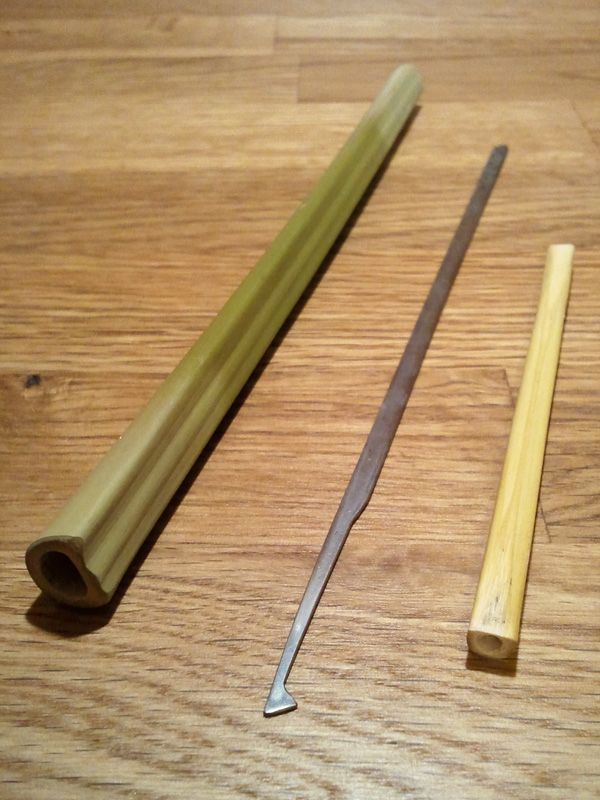

Postby femurat » 17 Jan 2011 6:38

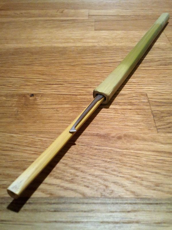

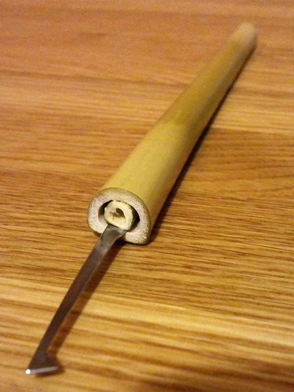

I'm happy with my bamboo picks but the handles are a bit thin. To get bigger diameter handles I tried another handle style. I choose two pieces of bamboo with different diameter, so that I could fit one into the other. Since the bamboo size is reduced during heath treatment process, I choose to heat treat the smaller one before starting. This way I hope the pick doesn't become loose after some drying of the bamboo that will occur with time. Notice the different colour, dried bamboo becomes brownish.
Then I had to file down a little the already flat side of the smaller piece, to make it perfectly match the flat bristle.
The next step was easy as saying one, two, three... I just had to push very strong to make it fit.
I tested the pick immediately, it's very comfortable and works like a charm! Even if the bristle looks loose it's firm in place and gives a very good feedback. I know the handle is too long, I'll cut it down later.
Next step is to heat treat the external bamboo. I'll keep you updated.
