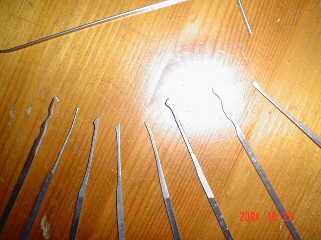

Postby Ultimatederrenfan » 26 Oct 2004 5:04
I'll see if i can up-load a few pics to show you what i was trying to say, the picture is my new pick set, i have managed to open my old front door, i say that because i am having a new one fitted, so i got to keep the old one, hehehe.
Dan

Postby Ultimatederrenfan » 26 Oct 2004 5:23
As promised, here is my pic of my picks, it is only a small set at the mo, i will expand to cover levers locks, autos and much more, i will save that for the advanced lock forum, anyways, sorry abou the lighting, my digi cam is poorly,
Dan

Postby poisoned » 26 Oct 2004 6:28
Nice :) Is that a tension wrench in the top of the pic? It looks huge :shock: :D

Postby Ultimatederrenfan » 26 Oct 2004 12:40
yeah, it is, it's because i havn'e got the bends in it shown on the picture, but if you want i will post a pic of that, it's a double ended one, im in the mood to pick even more now as i have just picked my first yale!!!
