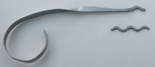

Talk about a dissapointing picking attempt. I had to remove the lever and disassemble it to get the pick out.
:cry: :cry:
[img][IMG]http://i211.photobucket.com/albums/bb277/cookiebear7/BrokeBogata.jpg[/img][/img]

The image looks to be broken, but dude. It always sucks when a pick breaks on you, especially such a reliable one as the Bogota. If you make another one, make sure you're not making it too thin anywhere near the end. That'll reduce the chances of breakage.

I think the photo will work now. I was so careful to keep any bumps or dents or thin spots eliminated. Oh well, back to the work bench.

Hm. It looks like you've not anything to worry about as far as craftsmanship goes. Seriously, it looks like you've done a great job. The only thing I can think of that would have caused that break is just plain old rough use or weak material.
What did you make this out of? That could shed some light on the situation.

This one was my most productive opening tool. It was made from a windshield wiper reenforcement stainless. Had very good spring to it. It was never bent and this was a complete surprise.
