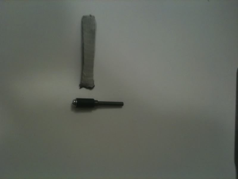

Start off by getting your sanding drum, and screwing the screw all the way out, thinning out the drum.

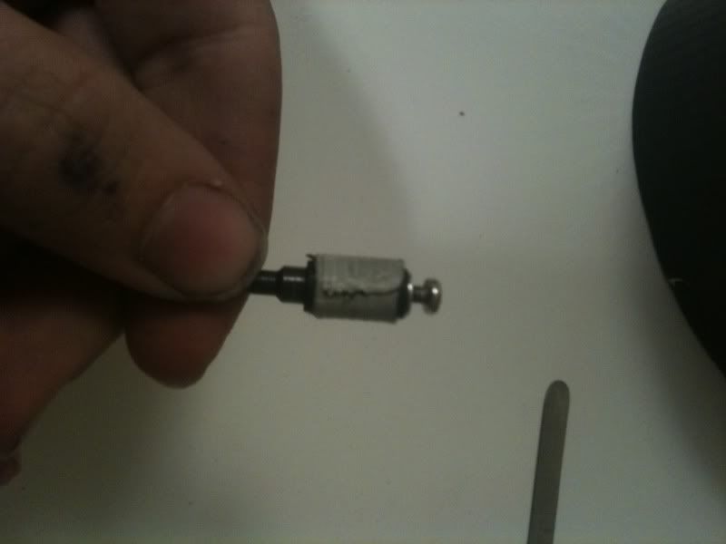

Next, grab your tape and get a strip that is the right size for the drum, I'm using some good quality duct tape.
Now wrap the tape tightly around the drum, sticky side out.

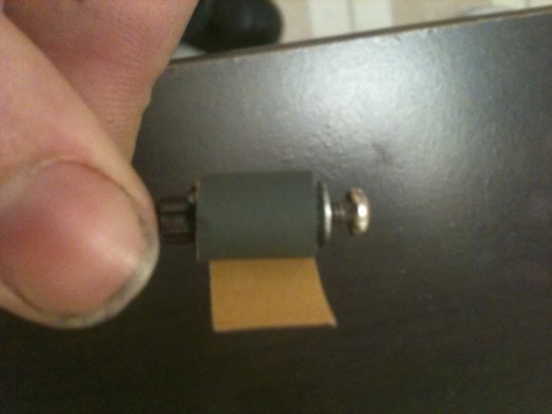

Now cut off a strip of sandpaper the same width as your tape.
And wrap it around, in the same direction you wrapped the tape.

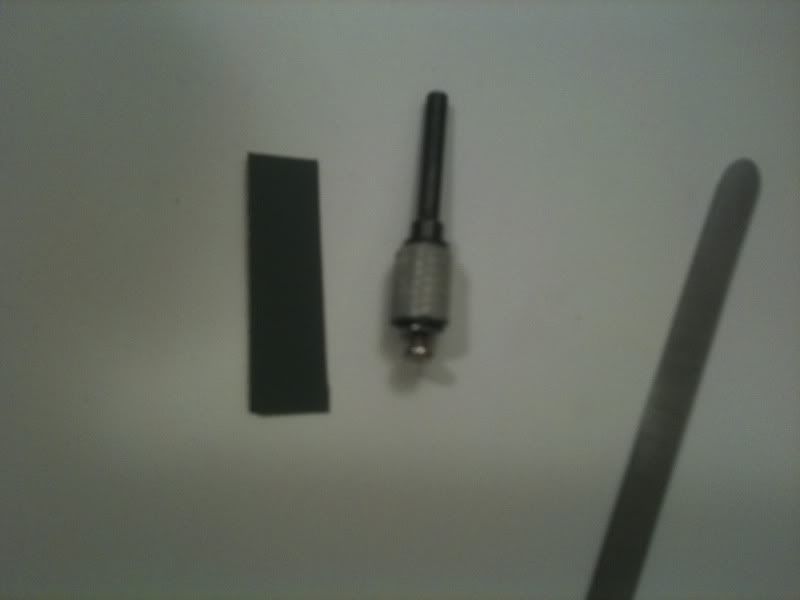

Trim off any excess as close as possible to the other side of the sandpaper, you want no tape showing, but you also don't want any sandpaper flapping about.
Sorry, blurry
Ok now tighten down the screw carefully, you don't want to stretch the tape and thereby widening the gap in the sandpaper.
