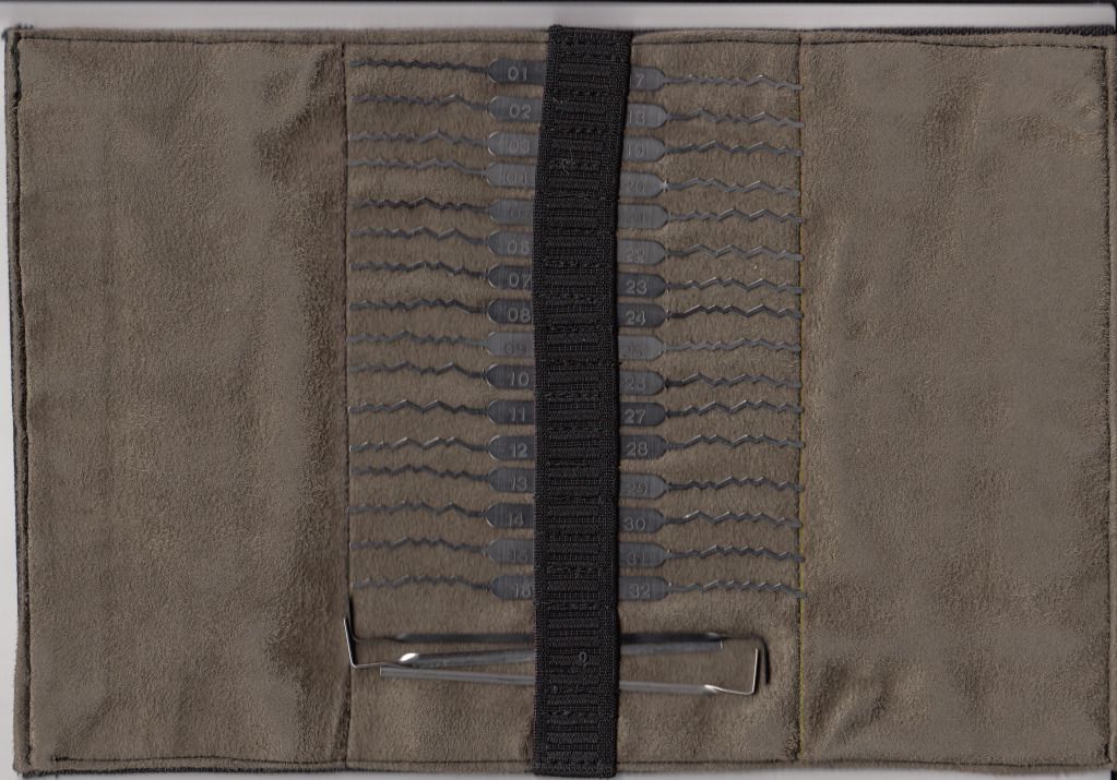

I wanted to show these to all of you. I found them while I was looking for some Falle wrenches.
As it happens, MBA appears to be the only source for Falle-safe tools in the US. While I was shopping I found these picks.
I have always been hooked on tools of all kinds. I have had plenty of luck with my normal picks, but when I saw these I had to have them. They look very similar to the HPC computer generated picks.
While I was there I ran into Mark and we got talking about the source of these picks.
I think that most of us know the story about the HPC computer generated picks. It is claimed, and this is the story I have been told, that those picks were actually copies of a set of picks designed by the Israeli, and that a security specialist made a photocopy of the original waveforms but in the process enlarged the image for greater detail. This is why the HPC picks are just a little too large. Anybody with differing or confirming info please, jump in.
Anyways, these picks are made by a French company called, obviously, Initial, and according to Mark are the original waveforms created by the Israeli.
When I got these picks they came in an expandable tool tube the likes of which you get with mill ends and certain drill bits. They come with a nice double ended tension wrench which would not scan well on my scanner but we all know what a tension wrench looks like.
When first opened they appear a little dull and the edges are quite sharp. The waveforms are very exact and well defined. My first use resulted in immediate success. I had a Schlage and Kwikset lock lying around and the Kwikset opened immediately. I mean immediately. The second pick I inserted opened the lock as though it were the key. I was able to repeat this with the same lock several times with different waves. The Schlage lock was a little more difficult but after a little manipulation was able to be opened shortly.
The only problem in the whole ordeal was the sharp edges of the picks made insertion and gentle manipulation a little difficult. I believed that the edges were catching on the softer brass of the keyway and pins. I sat down with a cotton rag and a tube of Flitz and after about an hour of hand polishing had polished the picks to a beautiful shine and very gently smoothed the edges. From this point on, insertion and manipulation was quite easy and I found no change in the performance of the picks.
My scan does not do them justice. They are very smooth, polished, and quite thin. If I am plan on using them for any period of time I usually have a couple of Band-Aids on to cushion the impact on my fingers.
I bought them more for a curiosity, though they do work, and they probably won’t make it into my field kit. Still, if you have $64 lying around they are cheaper, have more patterns and I believe work better than the HPC computer picks. Worth picking up.
Any questions, please feel free to ask.
~Jesse

thx for your good info and picture!
Could you please measure the thickness of the picks?
I have the chinese version of these. I made the same observation, that the tools were not "finished" properly . On some locks, the picks will open them straight away. However, on others it will not work.
My main reason for buying these, was to try them on ABUS padlocks. So far, the result is nothing.
If you should have some ABUS lying around, could I ask you to try your picks on those, and share the result?

I measured those picks, they are .024"/.58mm thick. Made of some alloy of high carbon steel. When I got them a couple had very slight corrosion on them, which polished off easily with the flitz. It didnt look like rust, more like intergranular corrosion. They are very springy but they will deform if used heavy handedly.

I worked on 3 different Abus 72/40 padlocks and had no luck opening then with these picks. Went thru the whole series a couple of times.
I am wondering if the padlocks with smaller key-ways/tighter spacing may not be as susceptible to these picks.
Also tried an American 5260 with no luck.
Rai,
I am not sure if the story about the computer is right, who knows where they really came from, right? Perhaps the computer story was
just created to give them either a more fantabulous origin or perhaps ENIAC was built for just this purpose...
You may also be correct about them just being random squiggles but I swear I have amazing luck with the 04/20 pick combo.
I haven't been trying every lock i own or anything but i had 2 schlages, 2 kwiksets and an arrow cylinder lying around my computer and the 04/20
was very successful in opening these 5 locks. More so than the other wave-forms.
Maybe there is some truth to the abilities of these picks or maybe i was just lucky.
And I think we all will agree that Medeco won't be bowing down to these things anytime soon.
raimundo wrote:they all have numbers on them so you don't try the same one twice before going through all 31 others if you are organized.
I made this for just that purpose. I wasn't going to show anybody because i am a little embarrassed about the precision with which it was made, but hey, i am not a seamstress.
I don't know if you've tried, but keeping elastic straight seems to be a pain in the, ah, donkey.
Anyways, I'll be keeping these things around. I like them well enough to play with.
~Jesse

Postby scriptguru » 29 Jul 2012 21:22
Just a small addition for DIY guys:
to print the above picture in real size, the resolution (DPI, dots per inch) should be set to 150.
Using Adobe Photoshop you can do it like this:
1. Open image.
2. Edit -> Image size
3. Uncheck "Resample image", set resolution to 150dpi, press OK.
4. Print the image.
