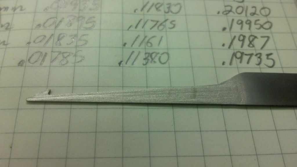

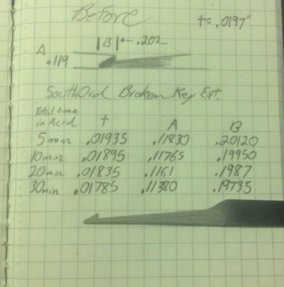

Now that I had a game plan, I started with a new pick. I grabbed a Southord broken key extractor. Since many of you out there may not have the Dino picks,
I figured I should use something we all might have. If this project ends up feasible, I would be able to apply the process to any pick and I don’t have any use for this extractor.
This is the before.
My final goal was to see how much I could remove without damaging the pick. I will explain why I stopped when I did, later.
These are the numbers from the first 4 dips. 5 min, 5 min, 10 min and 10 more minutes for a total of 30 minutes in acid.
Couple of pics follow. I will explain below the pics.

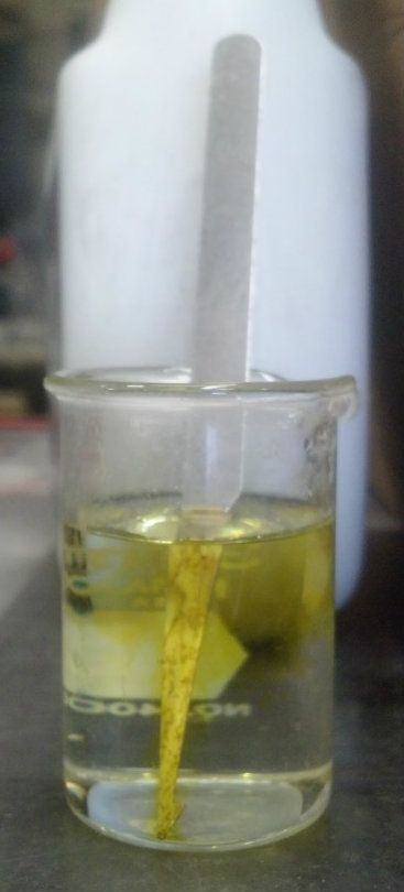

Pick during the first 5 min dip. Slight discoloration of the acid and metal.
By now you should have all noticed that I put the wrong picture in the first post. That is obviously not the Dino pick in the acid up there.
This is hard to see, but after 5 minutes the polish on the workin’ side of the pick was gone.
This is the pick after 30 minutes in acid. Obvious erosion has occurred.

So, let’s continue.

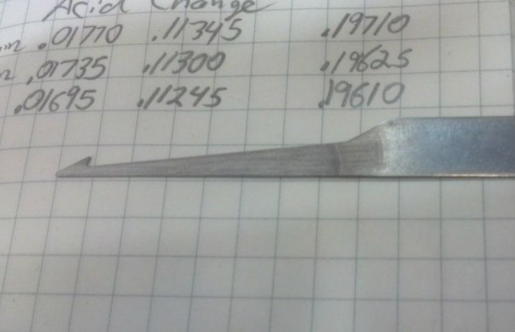

As I said, the next step was an acid change. The acid was not reacting very well after the first 30 minutes.
Turns out, nitro-muriatic acid kinda neutralizes itself the longer it is mixed, plus I was consuming it as I dissolved the pick.
The beaker was only 50ml worth of acid.
Here is the next series of dips.
5 min, 5 min, 5 min. Didn’t want to go too fast. The pick was showing signs of irregular dissolution and I didn’t want the shape of the pick to get away from me.
Better close up of the pick after 45 minutes in acid.
At this point I have reduced the pick thickness to .017”. I believe that I could have continued, I really wanted to see .015”, but the metal was starting to show channels and distinct irregularities and it was time to stop. The surface finish was very smooth to the touch in the way a matte painted surface is; smooth and soft, yet with an obvious texture. I took some 1000 grit sandpaper to it for 5 minutes of wet sanding. I timed this and limited it to only 5 minutes since the point of the reduction was to use acid and not wet sanding.
I hope the image is clear enough. The sanding put a very nice shine in the highest points of the flat. The dull parts of the picture are where the irregularities
were developing and were below the depth of the wet sanding. I removed another .0005” while sanding so the depth of the crevices are slightly beyond that.

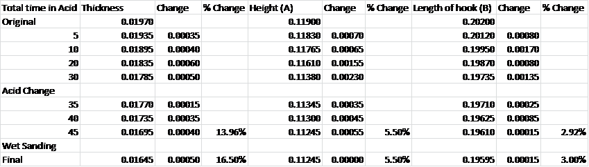

Below is a chart showing a breakdown of the individual dips, their associated measurements and changes per.
Now I must point out that of course there is the possibility of human error when measuring, especially when measuring something this fine. I performed to the
best of my abilities and I think the numbers are pretty consistent.

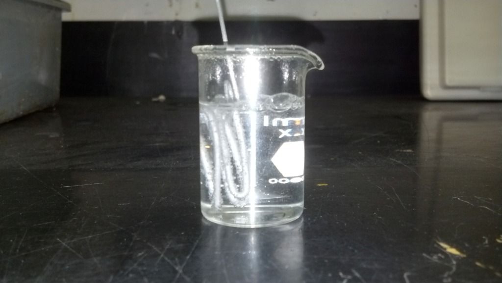

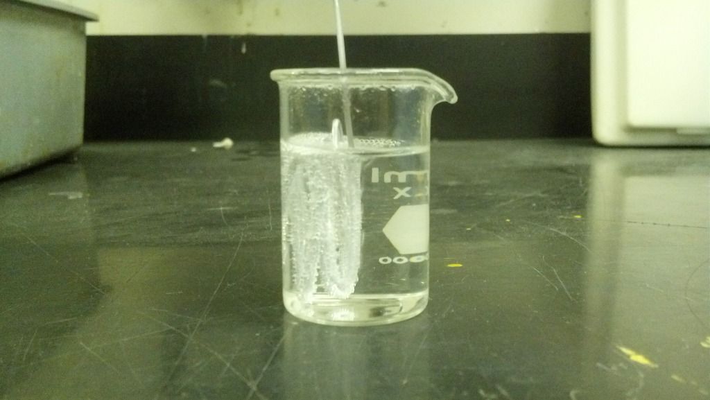

Raimundo, i read you post on my phone at work and I took a minute to make a little demonstration. The following is a vigorous reaction over a period of a few seconds.
The previous pictures of the SouthOrd pic were taken over several minutes.
This produced quite a bit of gas and if i hadn't been in a gigantic under-roof production facility i would have wanted a fume hood, or something.

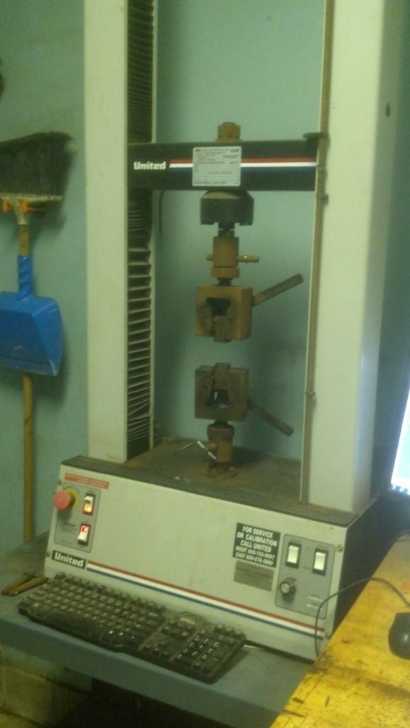

I also have a plan for a more scientific method of test. We perform tensile breaking tests on our wire to check the patenting, aka annealing, we perform. We use one of these.
It pulls the wire apart with a maximum tension of 6700psi.
I intend to use this to break 3 different version of the SouthOrd pick.

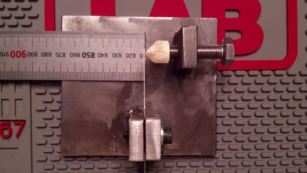

I decided that i wanted to test the flexibility of the pick before i broke the handle and decided to build a little tester.
I will finish fabricating it at work tomorrow and flex the picks tomorrow night. The tensile test will have to wait for Monday.
~Jesse

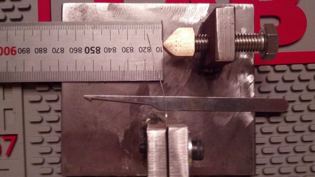

Postby Anavaree » 18 May 2012 21:12
OK, so I got to it a little late. Honestly I am too tired to post all the results of what i tested tonight but i will put them up tomorrow.
For now, here is the little test device I built. Its not very sophisticated but it works, mostly.
I have tons of pics of the testing I did. they have to be sorted and cropped properly. too tired. Must Sleep...

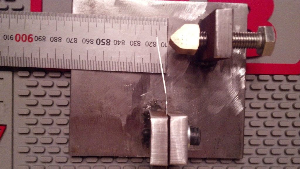

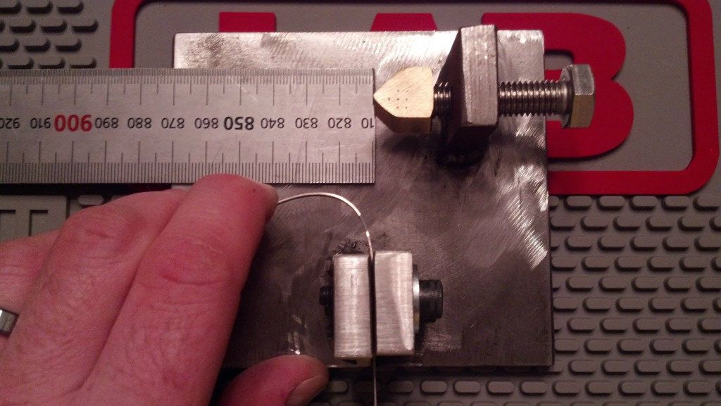

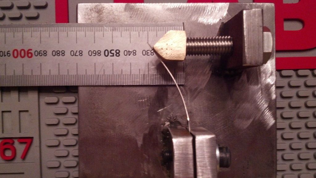

Re: Lock pick Vs. Acid
Postby Anavaree » 20 May 2012 20:54
OK, sorry to get back to it so late but I had a crazy weekend.

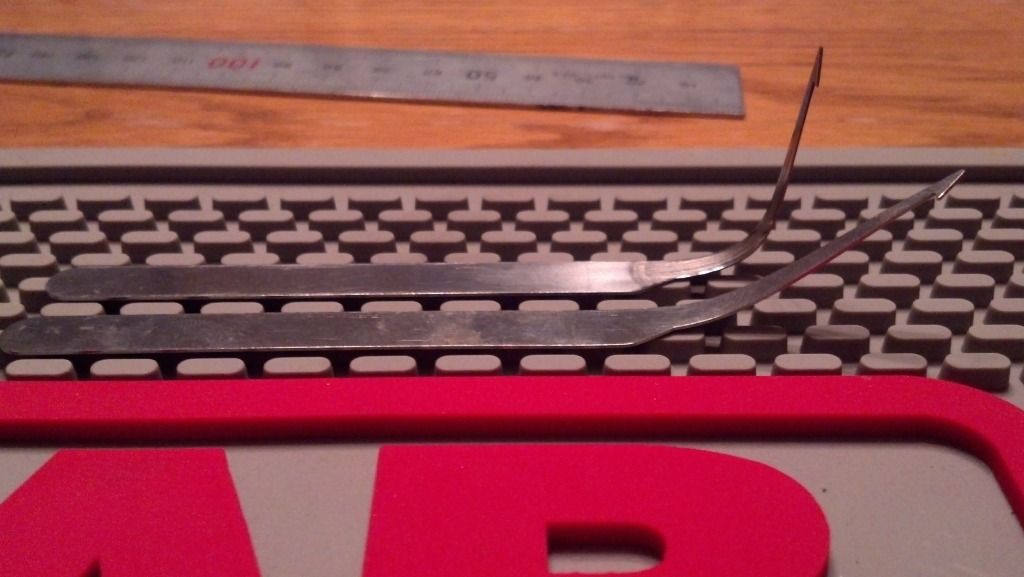

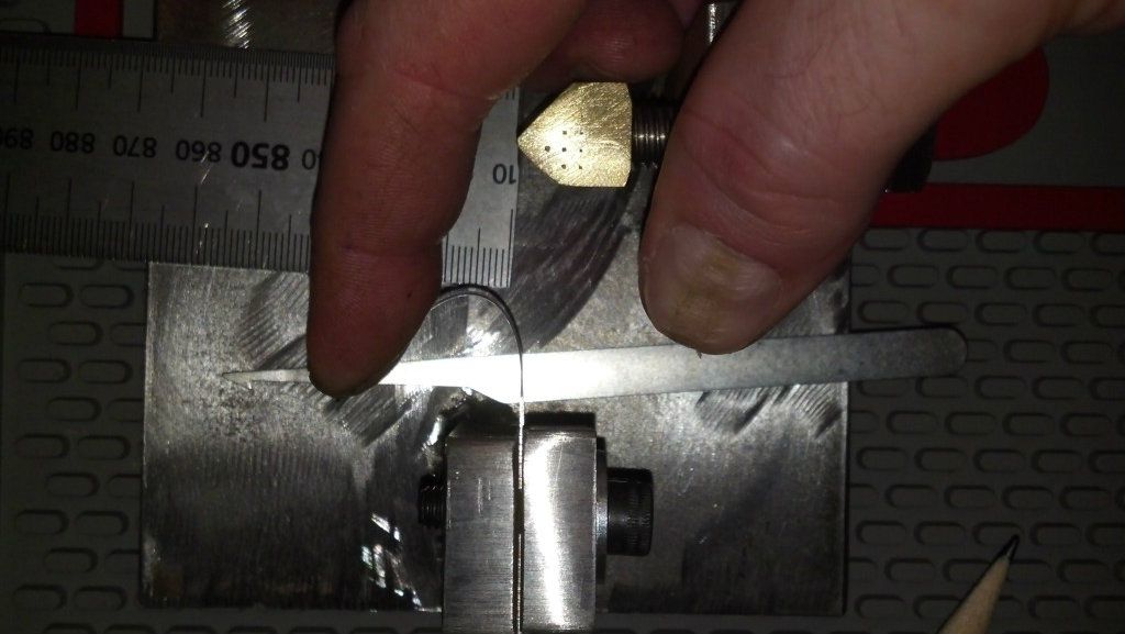

I already showed you the little contraption that I built to do the testing.

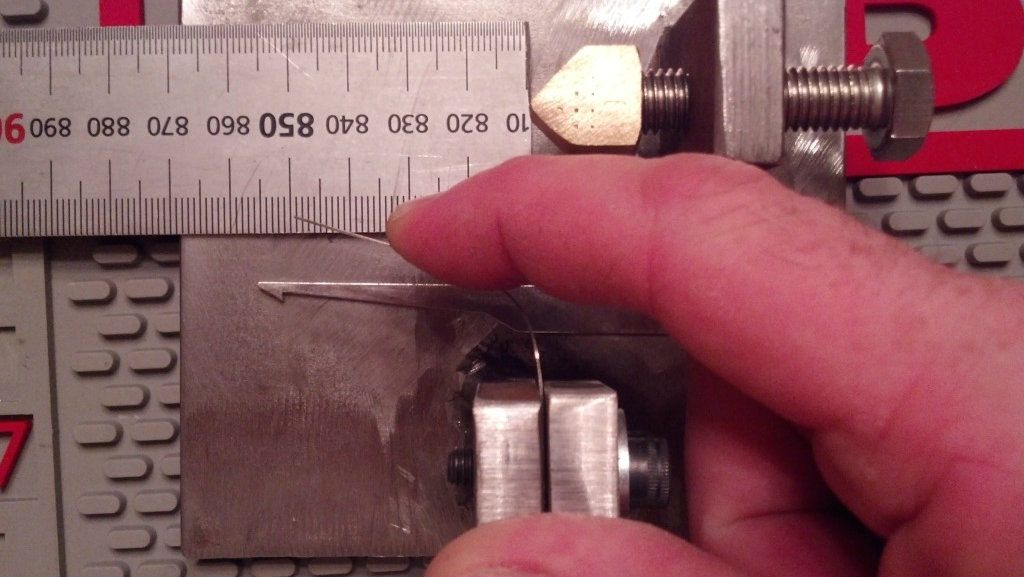

I will show the pictures in pairs, the normal pick first and then the acid dipped pick. However, I have just started going through the pictures and found that I am missing half of the pics that I wanted so I will do my best.
I deflected both picks 10mm and allowed them to relax. Neither showed any permanent bend. Then 20mm deflection. Again neither showed any bend.
It turns out that my little jig didn’t engage the picks enough and I had to resort to bending them by hand. The later pics will reflect this. I moved on to 30mm for both. The normal pick returned to normal and the acid dipped pick stayed bent about 1mm. still not a significant change.
40mm manual deflection.
I can't get this pic to orient properly.
The results once relaxed. Normal then acid dipped.
I really wasn’t getting any sort of important results so I really bent them over.
At this point I got both picks to bend and stay bent pretty badly. My final deflection was similiar for both but the acid dipped pick stayed bent much more than the normal pick.
The acid dipped pick is in the back.
In this picture you can see the grain of the pick starting to come out.
Both picks were able to survive a great deal of abuse and the only real question is; did the dipped pick stay bent more simply due to the fact that the metal was thinner, or, did the acid treatment change the properties of the steel?

Monday I will tensile break the normal pick and I will try to acid dip the whole pick handle and break that on as well but I never know how busy I will be at work.
