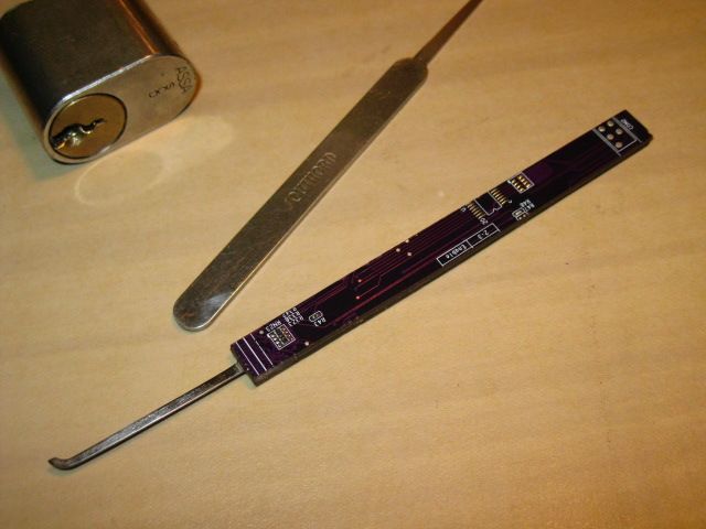

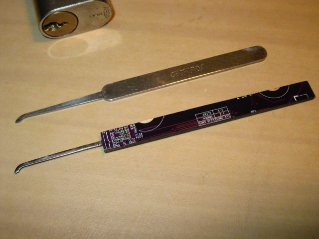

Heres a new hook i made with a high tech handle. Ive had these colored circuit boards for awhile and been wanting to make something with them- and here it is. This a first draft, i might refine it a bit more. It has good response and i think i like the look.
Note: I strongly suggest using a respirator if you do this kind of cutting, filing, or carving. The boards i have are lead free but my throat and lungs still feel a bit gakked hours after making this one pick (obviously i did NOT use protection :( )
Nuff talk:

Postby atticRR » 17 Oct 2012 21:12
thanks you guys! Ive got a few more colors to use which will be coming up-hopefully soon.
@femurat: the boards are thin, but i have two of them with the pick sandwiched between. I may slightly round the edges but right now its as comfortable as the southord in the picture.

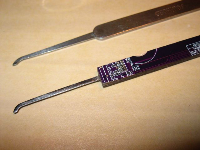

Postby atticRR » 18 Oct 2012 9:45
so just to clarify: The boards i started with were 1/16", so the two end up being 1/8" alltogether with a layer of clear epoxy bonding it all. As to the sides being rough on the hands- not at all, i chose the piece with that in mind as well as pattern. The edges cleaned up pretty nice, the traces are totally smooth. I am interested in doing the clear acrylic coat, i thought that would be pretty sweet as i could utilize an even more interesting bit of board. While i would really like to do that, i'm pretty lazy and will likely not get around to that level :roll: . .....

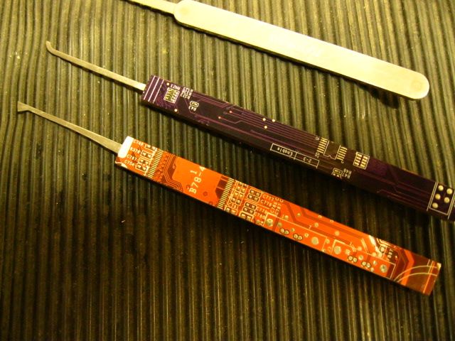

Postby atticRR » 24 Oct 2012 10:17
heres a companion for the hook, sorry bout the slight blur, im trying to get these posted before work.
