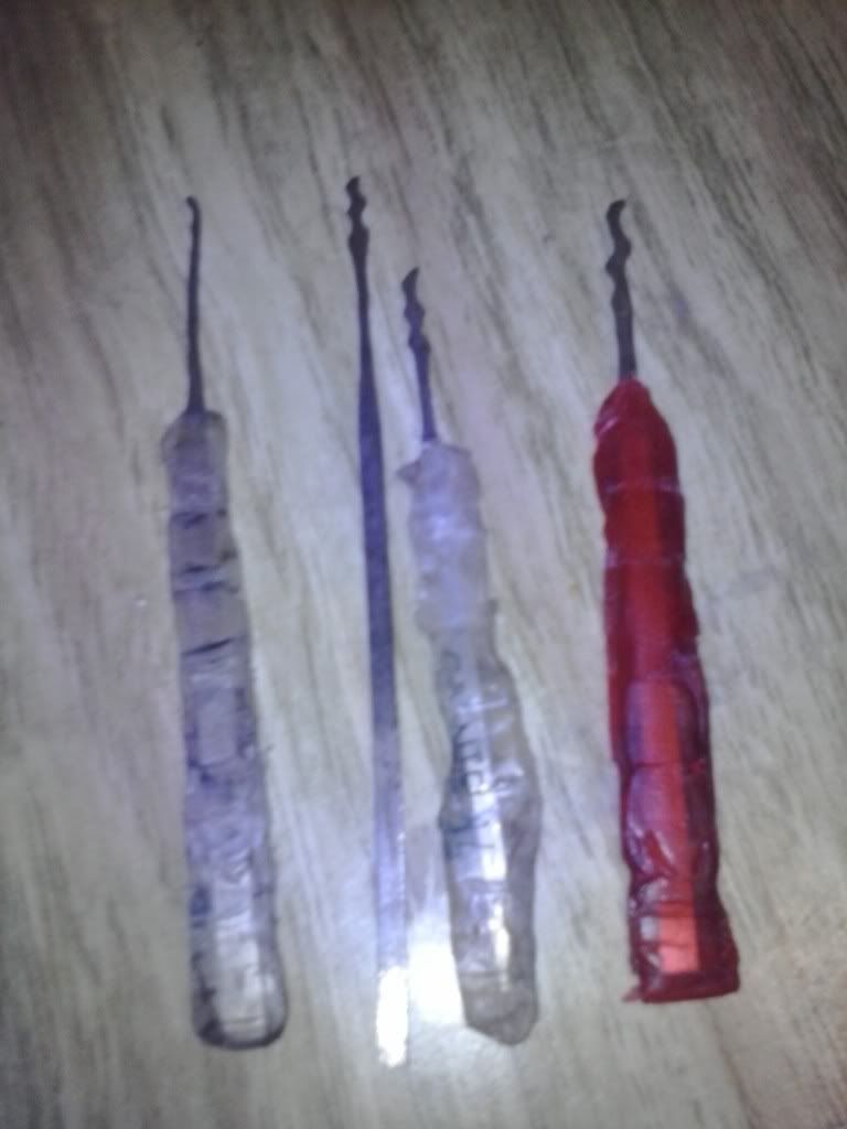

Postby anarchy_punk » 27 Jan 2013 13:32
Image lockpicks i made from window wipers insert
Expose yourself to your deepest fear; after that, fear has no power, and the fear of freedom shrinks and vanishes. You are free. Jim Morrison

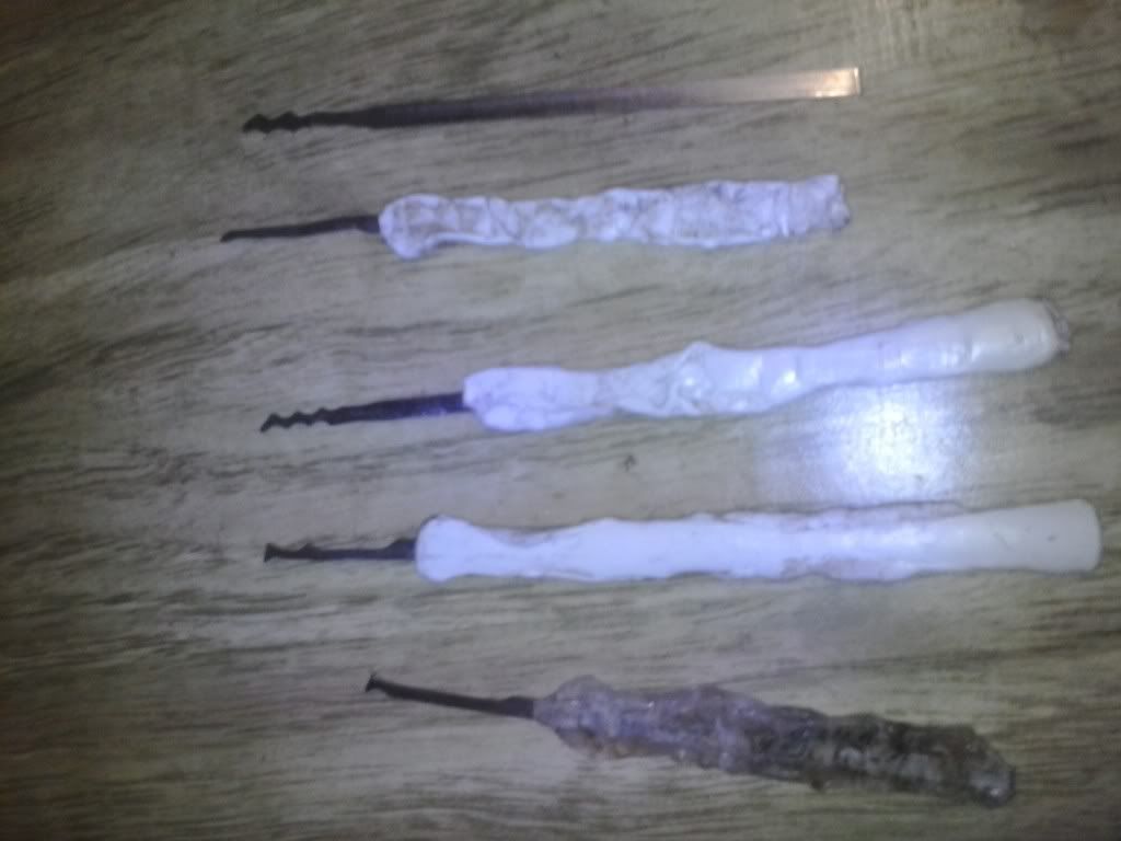

Postby anarchy_punk » 27 Jan 2013 13:35
Image made from street bristles
