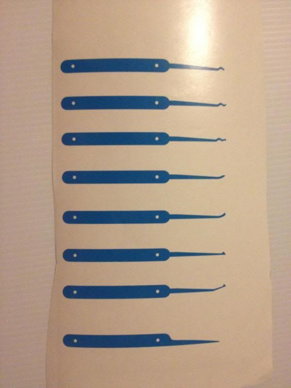

I used @Snikrepmada templates for the first test.
I still need to add weeding boxes, to make it easy to remove the excess vinyl from the sheet. Your sign maker will probably add a transfer sheet ontop. You then peal off the backing, lay the decal onto your tool material and then remove the transfer paper
Here is what I have so far:
Apologies for photo quality.
The metal should be cleaned very well, or I think they will shift during grinding / filing. Any household degreaser should work fine, or something like carboreta or brake cleaner spray.
Now to find myself an old wiper blade..........

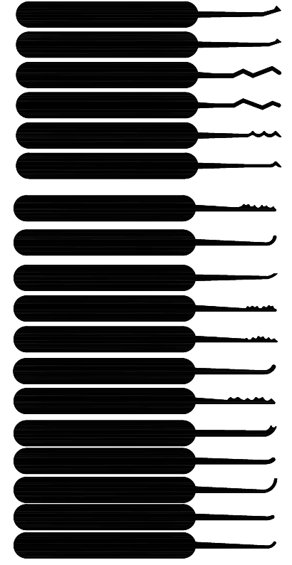

So I'm cleaning up and vectorising 2 sets that Mikus emailed me. Many thanks, Mikus.
I'll post pictures below of what I'm working on right now. I'm mainly cleaning them up so that they will cut nicely if you give the file to a vinyl cutter. I may be done by tonight :)
If there is another pick you see not included that you would like added to the RR Vector Collection, let me know and I'll see what I can do ;)

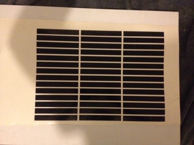

Cut out from the Vinyl:
Excess Vinyl weeded, leaving picks and individual weeding boxes:
Weeding boxes removed, leaving pick set. You can see I left some space for extra picks. Perhaps a bypass tool needs to be added? Now ready for application to steel to act as a very accurate and self-adhesive grind and file template:
I'm just working on uploading the .ai vector file to a host so you can download it at your convenience.
