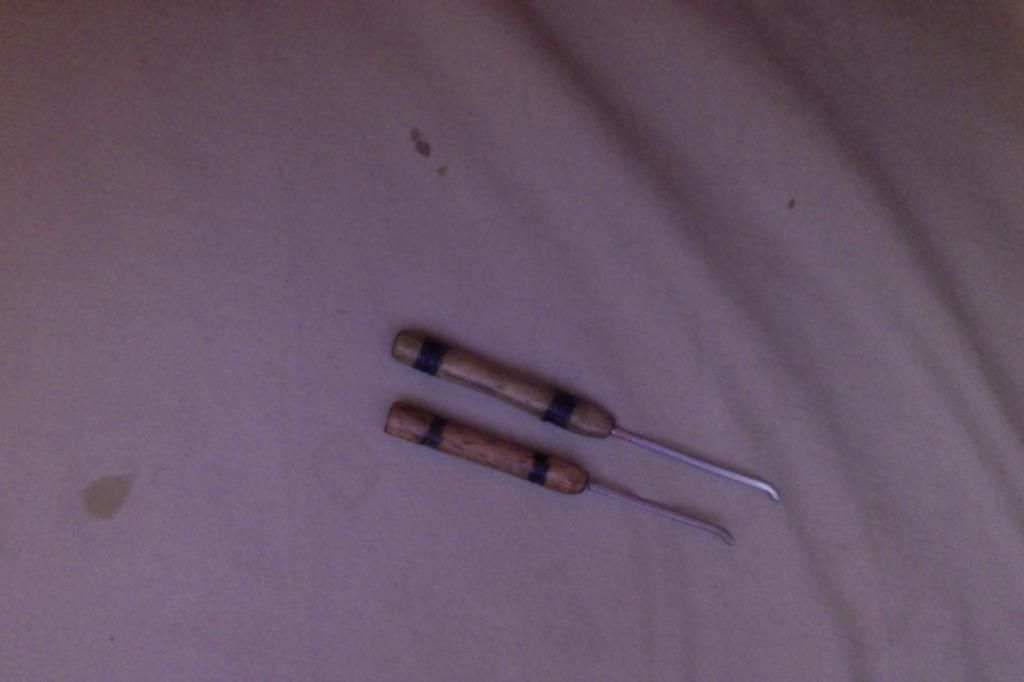

Postby cuttinedge1 » 8 Mar 2014 20:09
Sorry for the terrible picture.

Postby cuttinedge1 » 17 Mar 2014 19:23
Here is a new on I made with real wood
