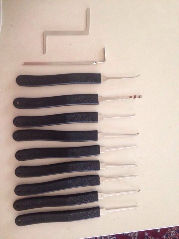

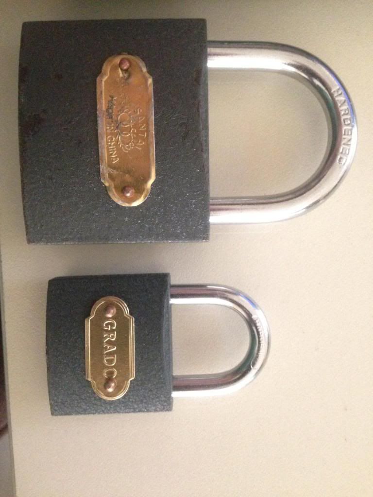

especially padlocks, i know how to pick a lock and what to do, and i know what's inside a lock, but for some reason it just doesn't work. i spend more then 30 minutes trying to pick a 3 pin padlock and it wont open, i tried it on many different locks of different sizes but they just wont open, what am i doing wrong. im using a pick set i got online for 10 bucks if that helps.

please post a link to the picks you are using... there is a chance the picks are total crap, plus you're a beginner, so it all adds up.

Your tri-circle / knock off padlocks have mushroom pins. look up spool pins, and mushroom pins, then practice for a month and you'll be able to open them. They are special pins that make the lock harder to pick, and it seems they're doing their job.
It's just a matter of practice and knowing what you're dealing with. Also that Deal Extreme pick set is not doing you any favors, those hooks are not what I personally would recommend to learn on. a $20 dollar Southord Euro set would be so much better in terms of getting a hook, proper half diamond, S rake, W rake, L rake, etc.

As for the picks, my biggest problem when starting out was too much tension on the wrench, and the wrong pick. This is a controversy, but I have always had better luck with the half-diamond as opposed to the hook. Others swear by the hook. I like the half-diamond because it's easier to rake the pins a bit if needed in my opinion. Having good picks is important, but too much tension will make even the most simple and basic lock seem like a high security lock, even with the best picks.

As i said before i was able to open a euro profile lock with these picks, and is it really possible for a 3$ lock to have security pins? Its been weeks trying to open them but still no progress. Anyways, can i make a cutaway lock with the big one? Cause im on a limited budget and i cant buy one.

Huh guess what, i gave up and drilled the big padlock open and found 5 spool pins, no wonder it was impossible to open, anyways thank you everyone for your options and solutions. Now i will keep the spools when i think im ready for them, but for now i will keep on the regular primer pins.
