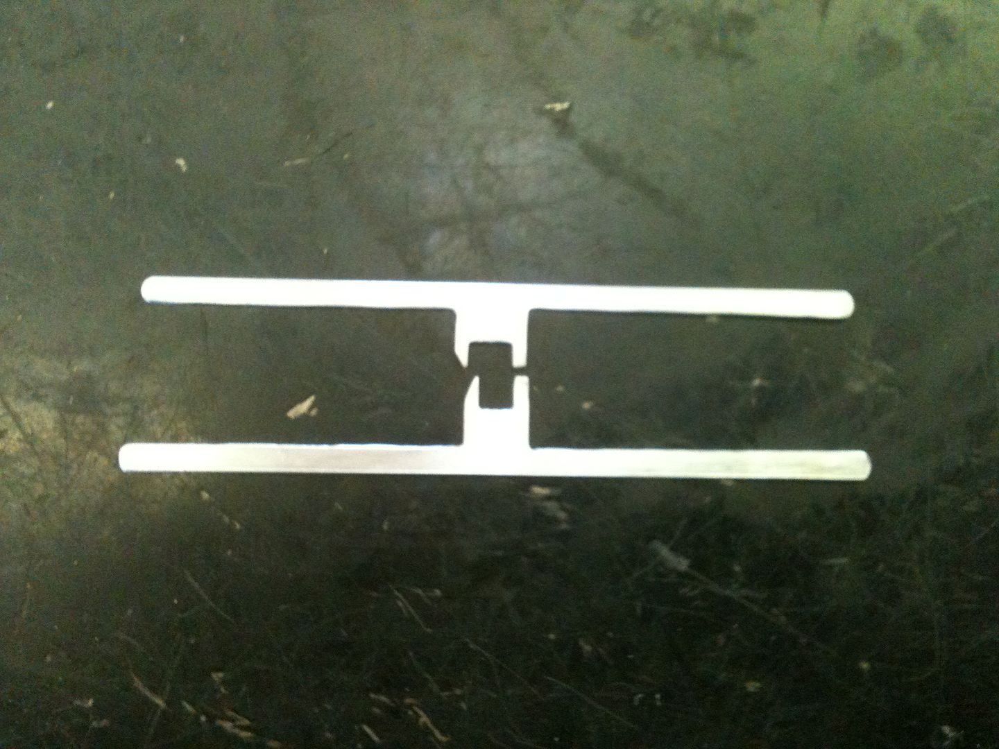

Postby cuttinedge1 » 1 Aug 2014 9:18
lamdamu wrote:i'm interested in tubular picking, i feel good with normal picking and i think it's time to start learning tubular picking, your photos can help me to do my own lockpicking for tubular.
You don t have to make a new pick just a new tension wrench. A regular hook can be used to press down tubular pins.
This is the picture I used to make my tension wrench. Paste this image into Microsoft Word and resize the picture until the inside spacing of the top (larger) gap in 1/4 inch and print it out. I used a truck windshield wiper insert so I only made the top part and did not make the warded picks. If you use other steel you can make the whole thing which is pretty cool. If you have a pair of calipers they are very helpful. The only tools you need are needle files.

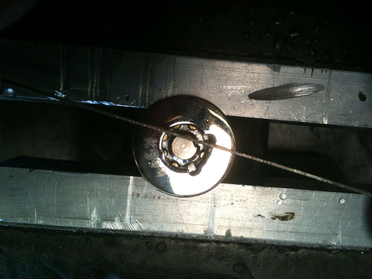

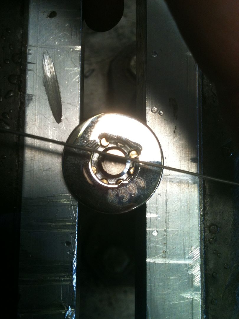

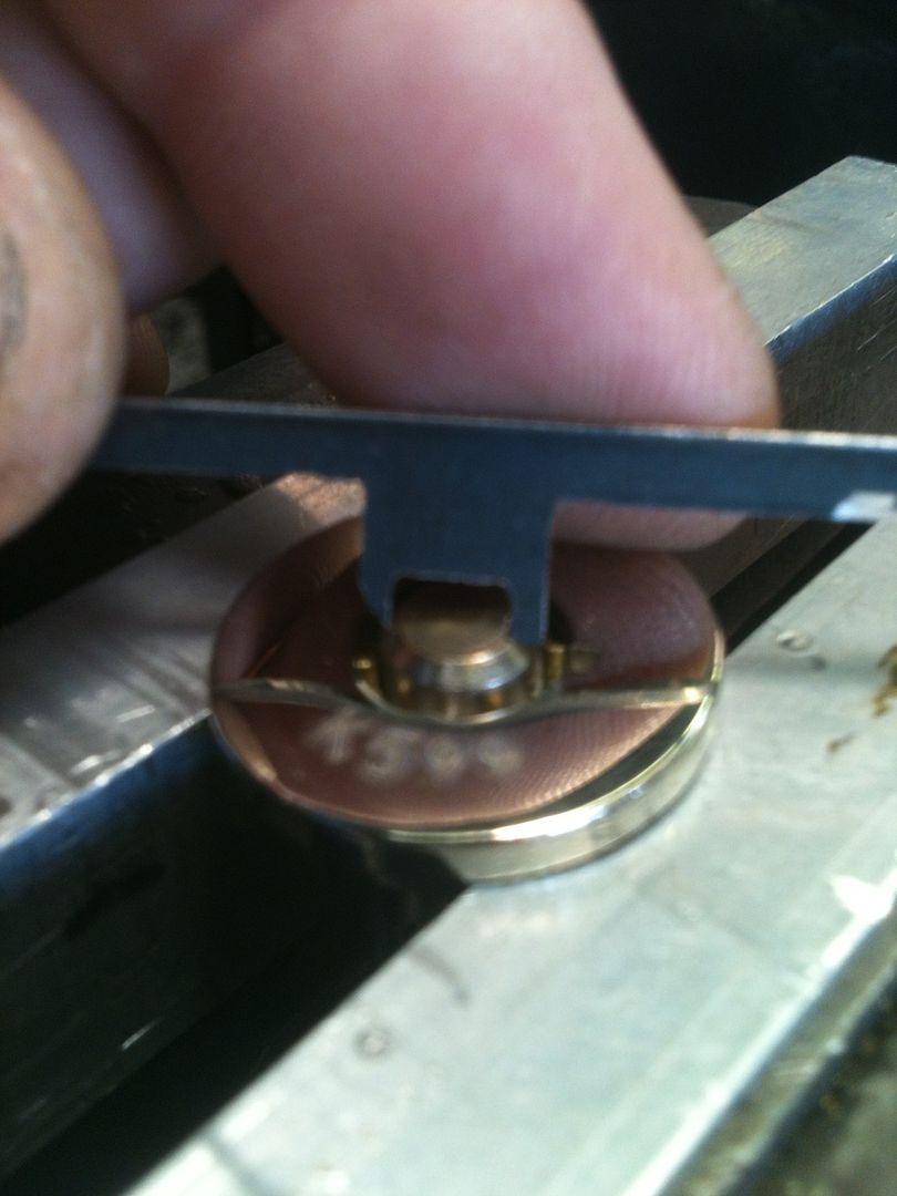

Postby GWiens2001 » 1 Aug 2014 21:28
That type of tension wrench is the basis for the tension wrenches I use the most with tubular locks...
These are made with hacksaw blades.

Postby cheerIO » 1 Aug 2014 21:51
Can someone post a picture showing how those fit into the locks?
Don't they block access to the pin at 6 o'clock?

Postby GWiens2001 » 1 Aug 2014 22:29
Here you go! The first picture shows how to fit the tension wrench into the lock, the second and third pictures show the two different size tension wrenches in the lock, so you can see how to choose which one fits the lock better.

Postby cheerIO » 1 Aug 2014 22:44
Oh, I think I get it.
The gap in the tool is slightly smaller than the line along the diameter of the plug from the bottom of the broaching to the other side of the plug. That way the tool puts a rotational force on the inside edge of the broaching when twisted.
