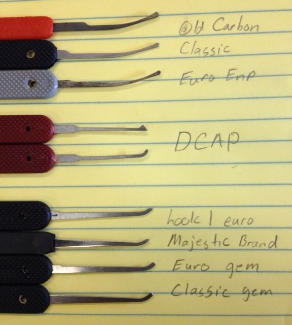

On masterlock no.3 or no.5 padlocks. I have noticed with standard southord hook pick. When starting from back of the cylinder going out trying to find the binding pin. The pick is pushing up slightly on other pins. This is causing some of the pins to set. So while SPP I might only need to set 2 to 3 pins and 1 or 2 pins are set by luck.
Does anyone have a preference or recommendation on a hook pick that has a thinner profile vertically? I've been looking at the slim or euro picks. But not sure if they are actually thinner vertically, horizontally or both? Anyways like to read others opinions and options.

I recommend some Peterson picks.
The Peterson slenders are thinner material. They are 0.015 or 0.018 thick. (blue or purple handles)
What you probably want are the DCAPs. Deep cut access picks. (red handles) Which are 0.025 thick like most of the euro and classic picks. (grey or black handles)
You can see the DCAPs in the middle of the picture. They have a cut down shaft to clear the pins.
Below them are some hooks and Peterson Gems so you can compare the shaft heights. The euro Gem and hook are a little cut down, but not much compared to the classics.
You may also want to try a Peterson Reach. Those are the ones at the top of the picture. I have had great success reaching around pins with these. If you have full use of the keyway you can really rock it all the way to the back while avoiding the more forward pins. As you can see, the newer versions have thinner shafts than the older dipped handled ones.

Thanks kpick and cheerIO. Definately helps seeing the picture of the different picks. I think ill get some peterson DCAP hooks.
