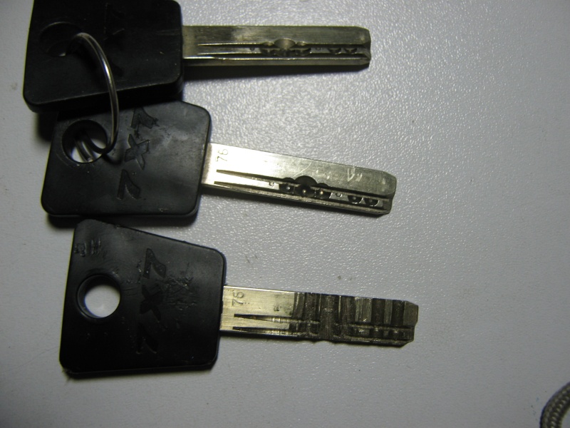

A very good analog can be found here, where the person uses a technique called impressioning to make a working key for a lock without prior knowledge of what the key looks like. Notice that the impressioned (filed) key looks pretty much like a dimple pick, and works just as well as having the real key with the nice perfect circle shaped dimples that the factory made.
http://mylockpickingworld.com/impressioning-3/
Has the bottom key been hand-filed? Does it work?

yes, and it works. the photos and videos are at this link: http://mylockpickingworld.com/impressioning-3/
