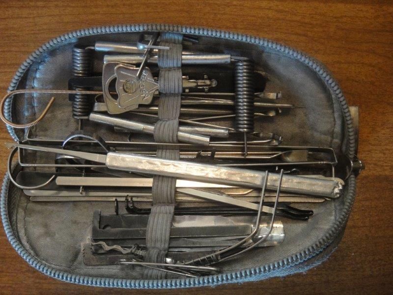

Those look very much like a bunch I made years ago for some lock picking classes at a hackerspace. Yes, a little sanding/polishing and those will work great. Still keep a set of them in my toolbox at work.
Also went to Lowe's (a hardware chain for those of you not familiar with them). In their hobby section, found aluminum tubing that, when compressed in a vise on to the picks, made great handles. The teeth in the vise even gave a nice texture to the handles. :)

Postby GWiens2001 » 13 Feb 2015 7:45
The pick on top in the center was the first one I made as described above. Used the flat sides of the vise, so it did not leave the cool pattern on the handle. But you can get the idea.
