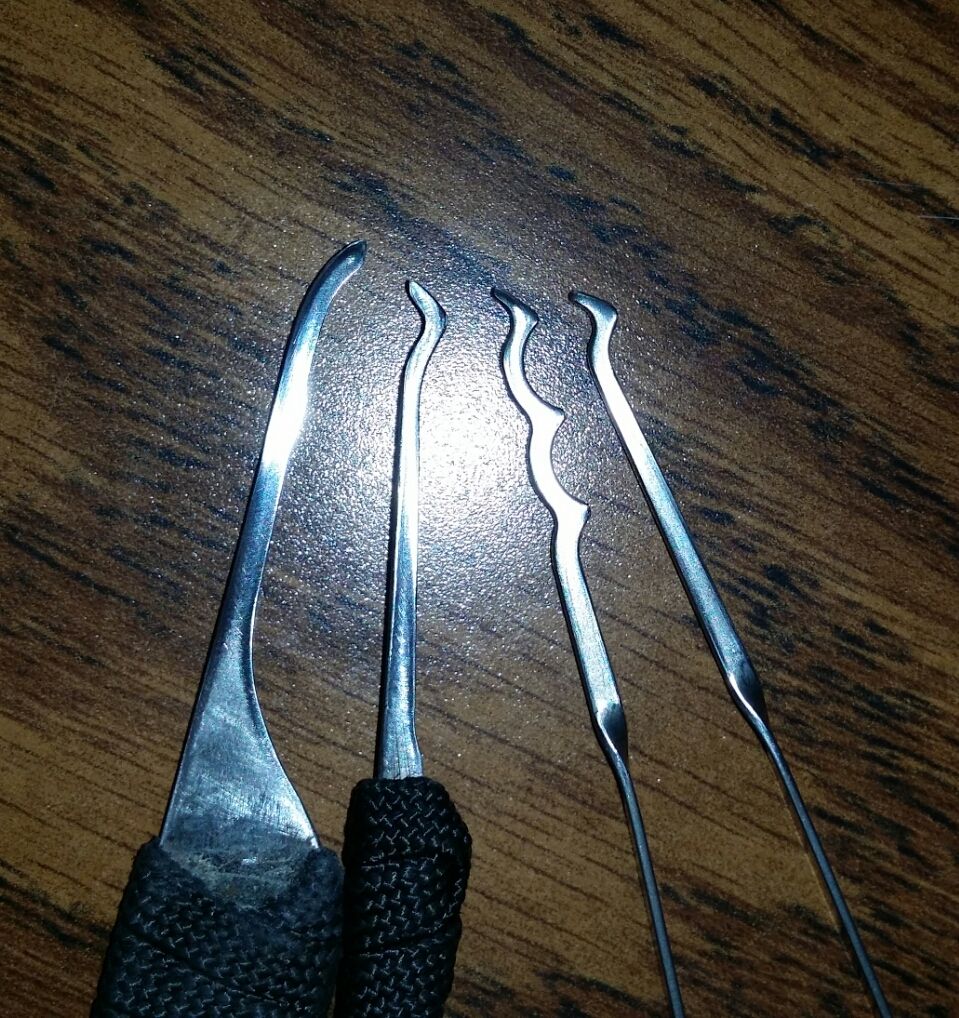

Postby Comrade627 » 20 Feb 2015 23:05
onionz wrote:I just tried sanding the edges of my new picks and ended up with a slice on my finder tip. Be careful when sanding them.
Same boat. Either way, maintenance complete.Image

Postby KPick » 21 Feb 2015 0:57
Nice! Your tools are mirrored out and they look good. How did you manage to get them so shiny and what tools did you use?
KPick
Posts: 623
Joined: 6 Jun 2013 22:13
Re: Pick Maintenance
Postby Comrade627 » 21 Feb 2015 1:22
KPick wrote:Nice! Your tools are mirrored out and they look good. How did you manage to get them so shiny and what tools did you use?
Easy day man.
As far as the polishing goes, I started with 400 grit sand paper and a smooth wooden surface (wood doesn't really scratch).
I'd go in circles on the pick with the 400 grit until it looked pretty even, then 600, 800, 1000, 2000.
No chemicals or waxes were used.
