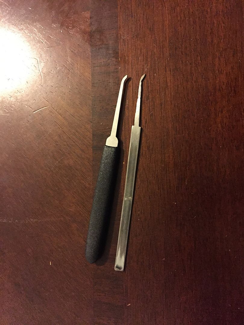

Postby CP_1993 » 6 Sep 2015 1:34
The one on the bottom is made from the steel insert of a windshield wiper and the top is a southord. Lol I do better work with the bottom. Image
