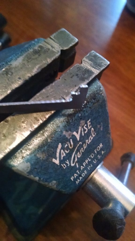

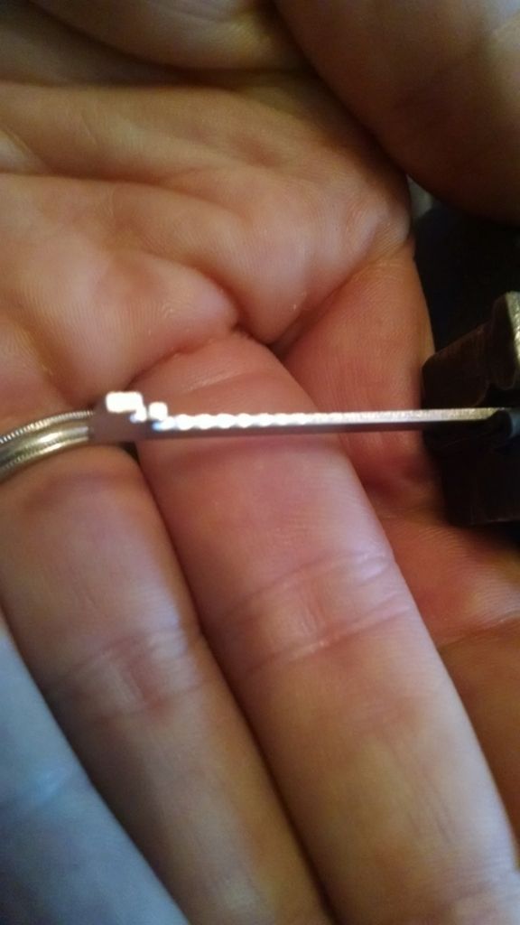

Good morning from AK! I am returning to sport-picking after a few years off. It was a hobby I loved in college, but then lost track of it with grad school, kids, work. etc. I'm really excited to be getting back into it. After some research online, I decided to buy a Peterson gov steel set. I was hoping it would be a significant upgrade from the old SouthOrd set I had used for years (I think the SouthOrd set was even an "outlet" set... pretty rough). I ordered the "Eagles Nest" set in the gov steel and my order came in quickly. After looking over the picks, I have some questions regarding the finish on the picks and wrenches. The cuts are "rippled' in many places both on the picks and the top-of-the-keyway wrenches. They are not a clean, flat edge. In addition, many of the picks have rough, sharp edges. For my comfort using them and to prevent them from snagging in the keyway, I am compelled to finish them with some wet/dry sandpaper and a diamond file. I have attached a few pictures of the rough finish (although my macro-photography skills leave much to be desired). The pics are of the wrenches, but the same ripples and roughness occur on the picks as well. Honestly, I would put their finish level on par with the much cheaper SouthOrd set I have owned for a while. I have no doubt the steel quality is significantly better, but I was hoping for more finish and comfort in a $80 set of picks. I wanted to know if this is typical quality for these sets? Or, did I get a bad batch? Thanks for all of your expertise in advance! I have been learning LOTS from these forums.

I also sent the same inquiry to the general Peterson company email address. Much to my delight and surprise, I received a reply back from Ken just a couple of hours later (and on a Sunday afternoon, nonetheless)! I am copying his answer here, as it is good info:
------------------------- Adam: I tried to call you, but the number listed did not go through. The characteristic you showed was from lasering where the gas flow causes the material to flex while being cut. Based on the hardness of the material extended tumbling does not remove those ridges. It does however remove the sharp edges so that safety should not have been a concern. Most people do not have a concern about it. I do however hear something about every 6 months or so. If I can't laser the turning tools, then I will not be able to make them at all. I believe you would find the operating end of the picks to be much smoother. When picking I don't tend to need to put a pick in a lock as far back as the slight rippling on your pick, so you should not have had an issue with that. HPC makes there picks of a softer metal using a punch press. It is common for them to have a flashing protruding from the sides of their picks. If you desire fully smooth picks you did the right thing. Many sportsters do so no matter what brand they purchase. If we had to hand sand them they would be unaffordable to most all of the industry and hobiests. I hope you enjoy the quality of the materials and Handels. Kind regards, Ken -----------------------
The conclusion of this one for me is that I spent an hour or two finishing out the picks in my Eagle's Nest set at the kitchen table... while I watched the kids play Legos and had a cup of tea. The results were great. The gov steel is truly a high-grade steel and finishes very well will a little extra time and skill. I'm quite thrilled with the "feel" of the set now and even more thrilled to have the additional knowledge about their production from the man-himself.

I too have gotten a few pick tools from Petersons that had these roller coaster edges. It must just be a machine out of spec or something, out of nine picks two were like that and three tension tools also. I just filed them smooth and sanded them to correct them. I did expect better though, for the price.

If you noticed, peterson adds an extra step then their process which removes the flat edges which most companies have after the metal is cut out. I dont know what or how but because of this extra process, peterson picks have a triangle edge. Its not perfect but I think out of the package, compared to all of the other picks I have, its usable. Plus its much easier and faster to smooth this angle to a nice smooth finish then a flat pick.

The letter from Peterson stated that they tumbled the tools. Years ago I started out in a stamping plant and some parts were tumbled after stamping. The tumblers used there looked like portable cement mixers, but were made specifically for tumbling. A batch of stampings would go in and as the drum spun the parts would be picked up and dropped on the other parts. It would do that for a few hours and much smoother parts would come out. The sharp edges basically wear each other down and from slightly rounded corners. The parts also come out with a very even matte finish. Maybe that is what rounds the corners on Peterson's tools? I have a tension wrench and a couple of picks from Peterson. The picks look great. The wrench has some ripples in it, but not enough to be anything but cosmetic issues. If it was from material flexing during manufacturing I'd think that the much thinner picks would have the problem instead of the wrench, but laser cutting is not something I have any experience with. If anyone is interested in laser cutting here are some interesting articles: http://www.thefabricator.com/?filter=article&category=lasercutting

Not sure if anyone posted it but Peterson cuts their picks by laser. With small parts like picks, they vibrate during cutting. Leaves ano edge with ripples. Tumbling only removes burrs from the cut edges. If you want a smooth pick, then the finishing is up to you. I don't polish all the ones the I use.
