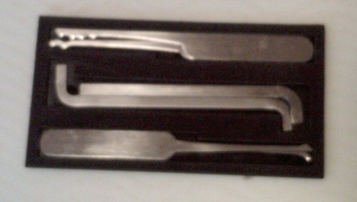

I was pretty intrigued by it due to it's compact size and the number of picks it concealed. Came today in the mail. When I opened the package, I was actually impressed with how thin it was. Only slightly thicker than a credit card. And about half the thickness of my Swiss Card. The design of the case was pretty straight forward...just slides open to reveal the picks.
Now for the picks themselves... They are pretty tiny compared to my Majestic picks (my only other set currently). Instead of having a full handle to get a good grip without much strength, the only way to get any purchase is to compress the base against the thumb and then wrap the index finger around it on the other side. Not comfortable in the least.
I tested it out on the easiest lock I have...my Kwikset deadbolt. I used every pick and tried for 15 min and none of those little bastards did a thing to open the lock!
My fingertips got sore from trying to depress all the pins while holding on to the little stub. But what I found was that the miniature size of the picks, while convenient for concealment, weren't allowing me to push the pins up high enough. I even tried angling the picks all the way from the bottom of the key way along side the tension wrench and pushing the pins up from there. no dice. As a sort of control, to make sure I wasn't just having an off night, I broke out my majestic picks. Pulls out a rake and standard tension wrench and I opened the lock right up on the first try., second try, third try...dropped down to the knob...same thing.
Maybe others can use these with no problem and, in time, maybe I can to. So instead of chucking them, I'll hold on to them. But right now...useless as tits on a boar hog to me.

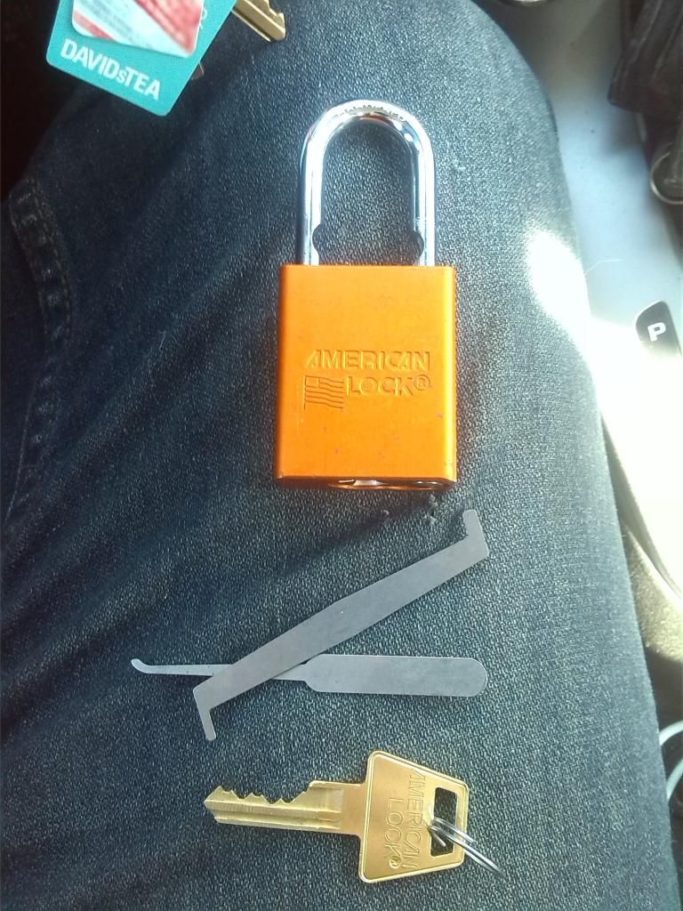

Postby blue60 » 18 Mar 2016 0:48
mine work good you just have to practice with them ;)
the hook works fine too, I just dont have a victory pic at hand with it :-)

I made a tension wrench for a credit card set using wiper insert .
It looks like the flat Peterson style.
I had to heat the material with a torch and bend it into the elongated "S", then grind the ends to fit the space.
Also had to hammer the bend to keep it flat , then do a little file and polish.
Two of them will stack in the space that the original piece went in.

Postby smokingman » 21 Mar 2016 14:54
smokingman wrote:I made a tension wrench for a credit card set using wiper insert .
