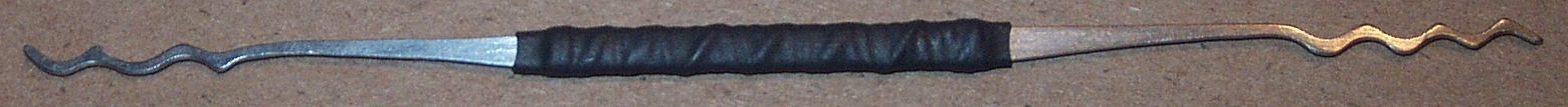

Postby PYRO1234321 » 12 Feb 2005 1:52
Ahhh, i can rember saying that in the video, but i do not really know why, perhaps it was a macgyver thing..... you know "a desert island and only one pick, what would it be?" type of thing. I'm surprised that a bottle opener and a knife edge wasn't suggested there.
I would like to clear the air and say that a pick should be a pick, and a hacksaw shoud be a hacksaw.
As for handles, the best so far for a home made one-piece-quick-and -easy that I have tried is heat shrink on top of a base of textured/designed string or tape. The whole idea is to build up the design or profile of the handle with the material or wrap pattern of choice and then lock it on with heat-shrink. It is not as elegant or structural as steel reinforced however this method can make handles with a samurai sword type of design which does add a lot to the "cool" factor.
The picture below is a simple double rake (wiper blade) with a sloppy layer of rolled teflon tape with radio shack heat-shrink on top (my first try at simple artistic handle design). As you can see, there is lots of room for texture variation based on how the base material is positioned.
