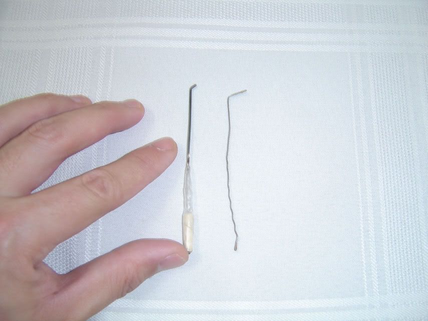

My attempt at making picks without power tools. Bunsen Burner annealed and tempered Improvised Hook and Torsion Wrench.
Does anyone have any favorite materials or techniques for creating impromtu picking tools? I've tried brick-strap, but it's hard to work with when you're just using a manual mill file and sheet metal cutters.

Small screw drivers bent to make a tension wrench
Paperclips for hook picks
Also safety pins for hook picks
With a small hand file, you could proabbly turn a tiny hex wrench into a tension wrench.
Other forms of metal that are already bent at a 90 degree angle, or are small enough to fit in a lock.

The picks look quite ok for starters. The one on the left is pretty close, but could do with being a little sturdier along the shank. Try using hacksaw blades and creating a gradual reduction in the height from the handle to the tip. The tip is where the actual picking is done, but you need the clearance beneath the forward pins...insert an un-finished pick blank into the rear of the lock and calculate the length required to clear a low-setting front pin (a pin that shouldn't be moved whilst picking a pin deeper in the lock) This length is typically the length of a key blank. Make the transition from the height of the pick blade to the handle as smooth as possible. A gradual increase is preferrable. Sharp increases induce stress at the slimmer point, which will result in breakages. Do a search for "pick templates", there are plenty of results. Look carefully at the shapes produced by the manufacturers...these are tried & tested designs. Rescale and print out these templates, then try to reproduce them.

what are those picks made of? they look as if they'd be easily breakable. :(
pun1sher
Posts: 39
Joined: 11 Jun 2005 19:05
Postby pun1sher » 20 Jun 2005 7:42
well, atleast the one on the right
