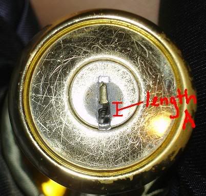

Note the distance between whatever you'll be pivoting the pick off of (in the case of the KW1 keyway, the lower ward) and the bottom of the pins, marked as length A.

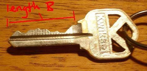

Next, note the length of the key from tip to bow, doesn't have to be as exact as length A, just make sure your pick is long enough to actually pick the lock. The length is marked as length B.

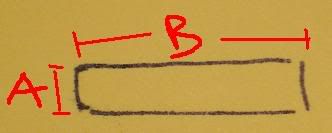

I drew this on a Post-It I had nearby, you should draw this on whatever you're using to help Dremel/grind your stock down to the right shape. Draw a square with length B, height A.

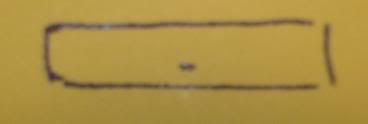

Make a mark above the bottom edge that'll mark the approximate width of the tang of the pick.

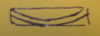

Draw a nice smooth curve from the top left corner, to the mark you just made, to the top right corner. Draw another one parallel (concentric, whatever you call two arcs like that), and you'll have the shape of the pick.

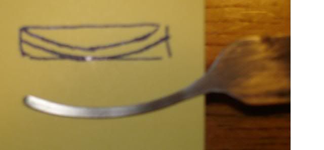

Stick it onto your stock and grind away, here's my first attempt from a while ago.

About the first picture: (the face of the lock)
You must have really shaky hands, you kinda missed the keyway a couple of times :lol:

Postby stick » 26 Aug 2005 22:17
:lol: That had been on my door for years until I replaced it about four years ago, after which it tumbled around in various boxes until I picked up lockpicking. It was one of the first locks I picked, and I undoubtedly added a few of those scratches with picks. :lol:
