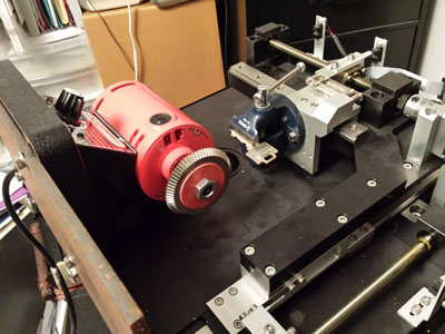

Postby ckc123 » 22 Nov 2013 13:18
Well. at the end of the second day, I have a stage working that will do the movements to cut the key (assuming a 100 degree blade, with only straight cuts required).
I made a video of the arm in action (cutting a Schlage key at 63636 code). I added a little "wiggle" at each major cut point to better illustrate the movements..
http://www.youtube.com/watch?v=CKr9LBYz ... e=youtu.be
Now I just need to find the right coupler so I can mount a blade on the motor I want to use (this is the hard part)..

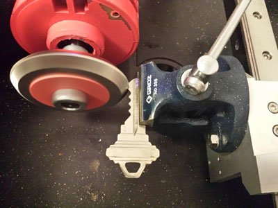

Postby ckc123 » 25 Nov 2013 22:14
IT LIVES!!!!!!! hahahahahahaha
Not the most user friendly, but does exactly what I need it to..
Total Cost = $206 in parts that I didn't have on hand.. ($80 for a motor since the old one did not have the correct arbor size, $120 for the cutting blade. $6 for the mini clamp)
Now. include the cost of the high precision X/Y stage $20,000 (yeah it was from a machine that we paid 20k for.. paper weights now..)

Postby fgarci03 » 26 Nov 2013 5:30
Congratulations mate! :mrgreen:
The cuts on the key look pretty nice!
Would you care to post a full tutorial on this? :P And maybe a video of a key being cutted?
It really looks insanelly cool, brilliant idea you had there!
