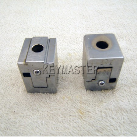

In my Hudson 598B machine the key holding jaws have 2 sides to them. One side looks like a Z shaped and the other like a trapezoid.
Here is an example image: http://g02.a.alicdn.com/kf/HTB1f0XSKFXX ... hine-b.jpg
My question is: for which key types do i use which jaw? There bound to be an intended application for each... So far no luck googling user manual for the machine, mine came off ebay...
Thanks ahead

Keys like most house keys, that are only cut on one side used the 'stepped jaw', that jaw has a flat bottom, where the bottom of the key sits.
Keys that are double sided, like most car keys, are cut on the other side, where they are held by a milling often found in the center
of the key.
The stepped jaw is the one to the right side of the jaw shown on the left

billdeserthills wrote:Keys like most house keys, that are only cut on one side used the 'stepped jaw', that jaw has a flat bottom, where the bottom of the key sits.
of the key.
Thanks. I forgot that the car keys are cut on both sides and have a groove in the middle. My car key is a wafer key, but both sides are flat and the milling is only on the faces...
