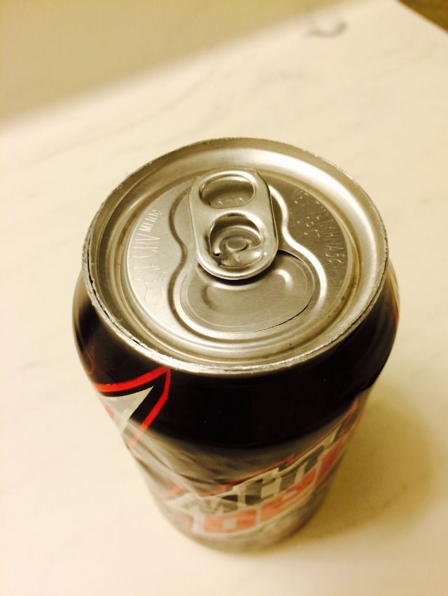

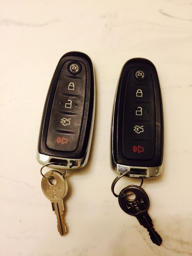

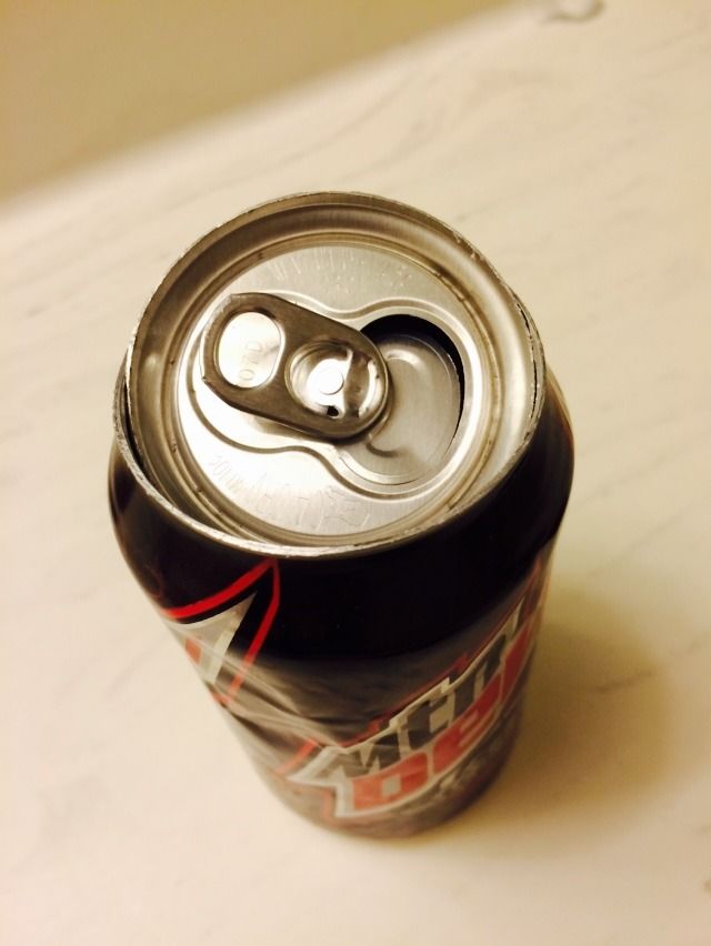

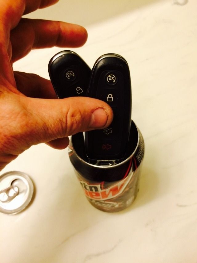

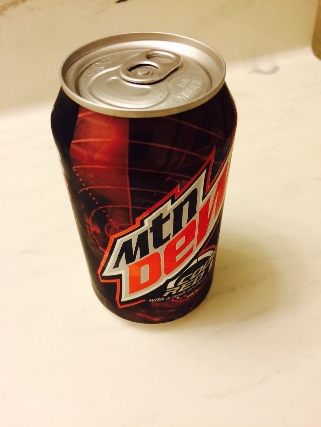

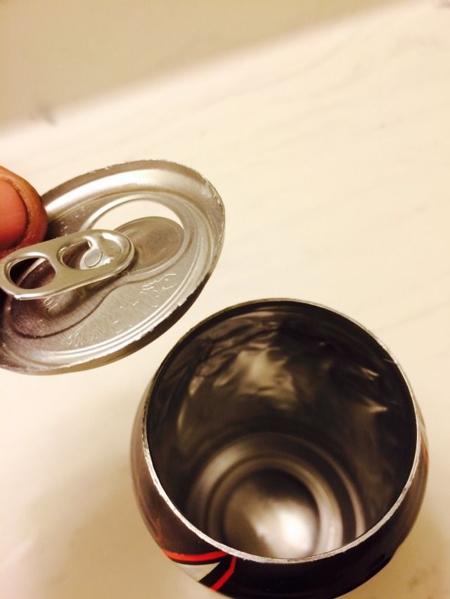

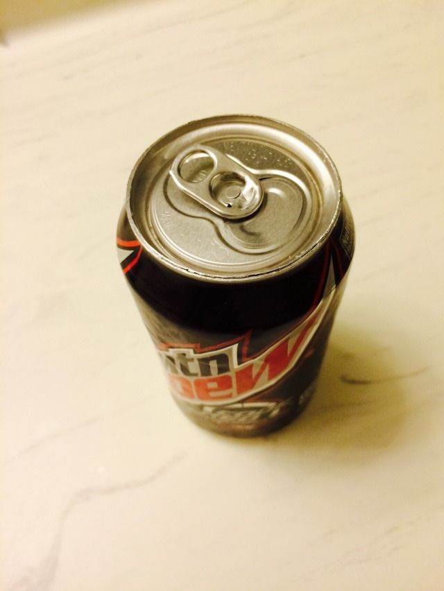

Postby GWiens2001 » 1 Jul 2015 22:18
A quick method to keep your car with the ‘smart keys’ (keyless opening and start) from being opened or started when at a hotel.
Am at a hotel right now, starting a trip. My vehicle (a 2013 Ford) has keyless everything. Don’t want people getting into the car tonight, so here is a simple trick I am using (and it works).
You may have heard of building a Faraday Cage to protect the keys from signals. This is much cheaper and easier.
1. Get a soda can.
Use a cement curb or sidewalk to grind around the entire top of the soda can.
Lift off the top that is now cut free by the grinding on the curb.
(Wipe out the soda inside the can, too).
Take your keys:
and put them in the can.
Put the lid back on.
As my son can confirm, you can have the can right next to the lock, and the door still won’t open. Nor will the vehicle start.
Cheap and effective. Hope this helps some people out.
NOTE: Aluminum foil works well, too. But did not have any with me on this trip. Soda cans are everywhere. :mrgreen:
Posts: 7662
Re: Once all cars have Smart Keys....
Postby 2octops » 3 Jul 2015 1:55
You're only blocking the signal from the prox fobs from reaching the car. You're doing a great job of protecting the keys.
You need to put the entire car in there to protect it.

Postby dll932 » 18 Aug 2015 16:03
2octops wrote:You're only blocking the signal from the prox fobs from reaching the car. You're doing a great job of protecting the keys.
Maybe not:
http://www.nytimes.com/2015/04/16/style ... ieves.html
"When I told him my story, he knew immediately what had happened. The teenagers, he said, likely got into the car using a relatively simple and inexpensive device called a “power amplifier.”
He explained it like this: In a normal scenario, when you walk up to a car with a keyless entry and try the door handle, the car wirelessly calls out for your key so you don’t have to press any buttons to get inside. If the key calls back, the door unlocks. But the keyless system is capable of searching for a key only within a couple of feet.
Mr. Danev said that when the teenage girl turned on her device, it amplified the distance that the car can search, which then allowed my car to talk to my key, which happened to be sitting about 50 feet away, on the kitchen counter. And just like that, open sesame
“It’s a bit like a loudspeaker, so when you say hello over it, people who are 100 meters away can hear the word, ‘hello,’ ” Mr. Danev said. “You can buy these devices anywhere for under $100.” He said some of the lower-range devices cost as little as $17 and can be bought online on sites like eBay, Amazon and Craigslist.
Mr. Danev said his company was in talks with several car manufacturers to install a chip that can tell how far the key is from the car, thereby defeating the power-amplifier trick.
While I can’t be 100 percent certain this is the device they used to get into my car, until car companies solve the problem, he said, the best way to protect my car is to “put your keys in the freezer, which acts as a Faraday Cage, and won’t allow a signal to get in or out.”"
