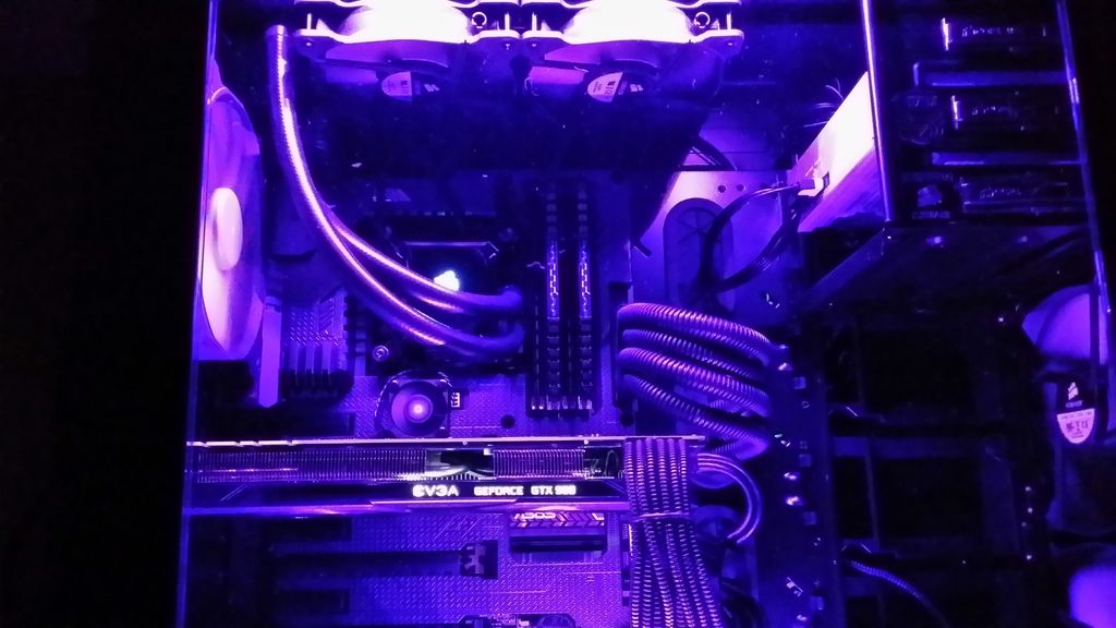

Well while we're at it. This one place that goes by "Comrade's Customs" is baaaaaad a**. From my experience, the dude makes the coolest looking themed custom PCs out there for cheap (usually 10% of the total machine cost plus extra parts)! I'd so buy one if i could.
