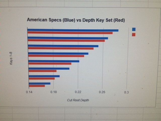

if the depth and space keys are not exact to what it says in the book, then yes they are bad. i would request a refund. I traded with a member for a set of D&S keys which were cut on an HPC blitz and they are EXACT. the seller might have just copied the original code cut keys, maybe that is why they are off.

It was easier for me to visualize when I put the numbers into a little spreadsheet and made a graph:

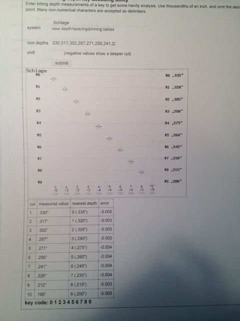

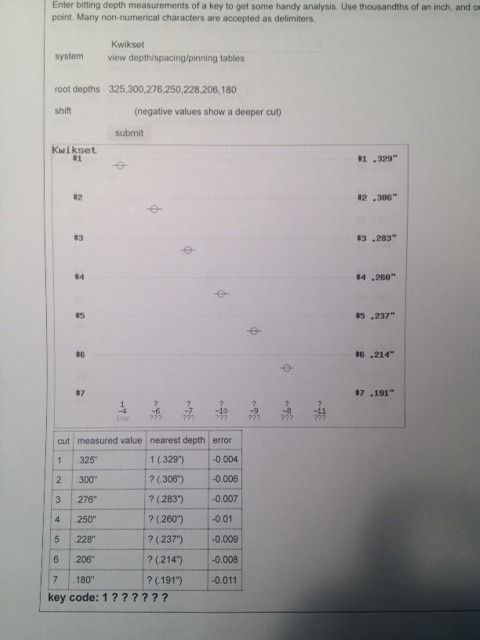

The keys wouldn't work at all. Especially 5 and 6. I found a bitting utility online and input the measurements for my KW1 and SC1 sets also from the same source:
The Kwiksets are so low, the calculator could not even figure out what bitting they were supposed to be. And the Schlage were all low across the board.
