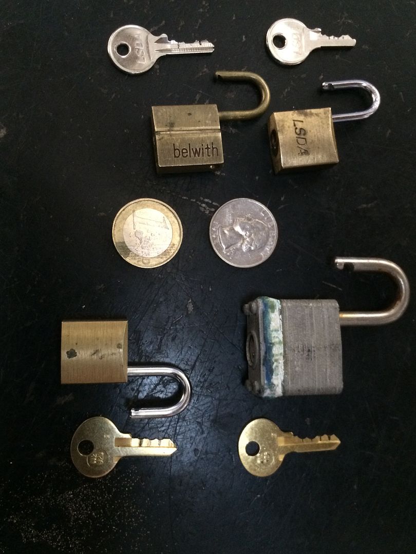

Postby GWiens2001 » 2 Apr 2016 19:08
Slow at the end of the work day. So had time for a little impressioning.
:D
Posts: 7680
Re: What Did You Impression Today?
Postby femurat » 2 Apr 2016 23:21
Thanks for the euro coin. Even from this side of the pond we can see how tiny those padlocks are.

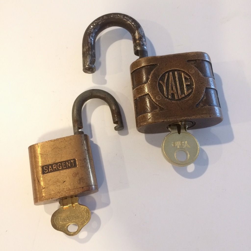

Postby Robotnik » 16 Apr 2016 15:47
Haven't impressioned much lately - been quite busy - but had the time to knock out another mini Sargent (S10 blank) and a Yale 850.
While the 850 had a blind code stamped on the plug - and I have a Yale code book - my code-cut key didn't work. Lock doesn't appear to have been re-keyed, but my working impressioned key and the code key weren't even close to each other.
Robotnik
Posts: 670
Joined: 3 Aug 2014 16:21
Postby jeffmoss26 » 16 Apr 2016 17:06
mmm Yale. Nice job!
Postby GWiens2001 » 16 Apr 2016 17:25
Jeff is commenting on the Yale, and not the Sargent? The poor man must be quite ill. Hope you feel better soon, Jeff. :)
Have come across enough old Yale locks in which the blind code did not work that I have all but given up on the codes for them.

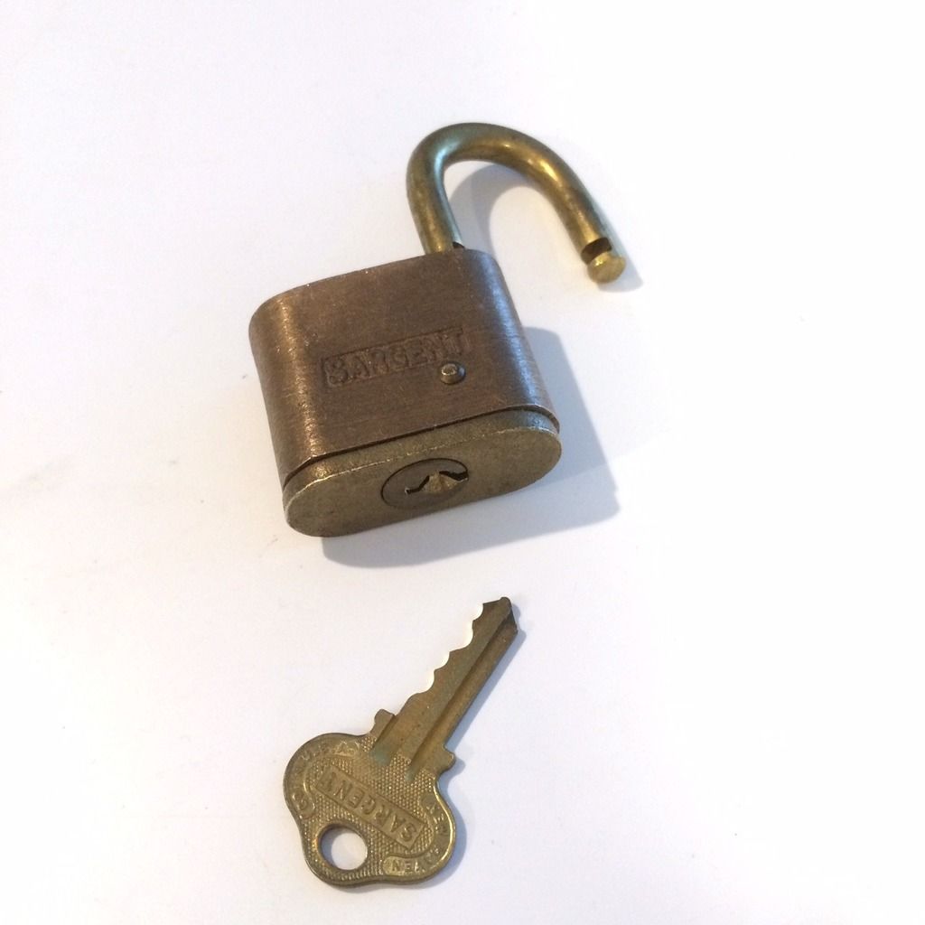

Postby Robotnik » 17 Apr 2016 17:08
One more (slightly different) small Sargent knocked out today. Have heard this specific type was used on mailbags, but don't know for sure.
