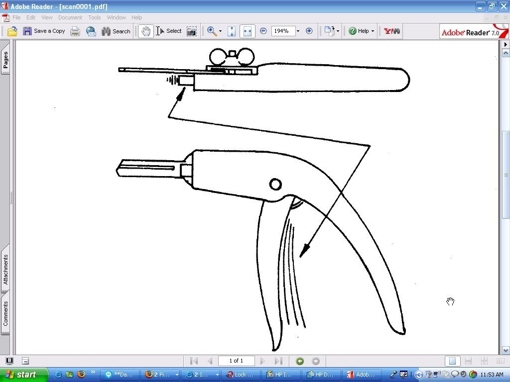

Postby globallockytoo » 18 Aug 2006 14:36
http://i115.photobucket.com/albums/n283 ... iongun.jpg
This is a diagram of the impression gun....
It is fairly common and easy to make...but is sold by various locksmith supply companies.

Postby Schuyler » 18 Aug 2006 16:24
Is that shot taken from a larger PDF on the subject?

Postby globallockytoo » 21 Aug 2006 1:02
Schuyler wrote:Is that shot taken from a larger PDF on the subject?
No I just scanned the page from the book and made a screenshot of the pic to reduce the size of the image....
The impression gun is relatively inexpensive to purchase and is a great aid in teaching the finer points of pin tumbler impressioning.
By setting the shoulder of your blank close to the plunger...you can adjust the depth that the plunger pulls your blank out of the plug...
Using this system it is very simple to plainly identify which space is marking clearly...
To anyone learning to impression...it can be of great assistance...once mastered...you will turn to your trusty vice grips in almost every case, becuase you will know exactly how much pressure is required

Postby Varjeal » 21 Aug 2006 9:47
Still not quite clear on how this tool works. Does pulling the trigger cause the key to slide in/out or up/down?
If it's up and down then it would require removal of milling on the key and a slight twisting motion to acquire the marks (unless the amount of movement it makes is minimal) in which case a pair of vice grips or clamping tool will perform the same objective, which makes this tool rather...umm...redundant.
So unless it's cheaper than a good set of vice grips I fully understand why I haven't heard of it before.

Postby Shrub » 21 Aug 2006 9:58
I summised it actually worked like a pick gun in that it moved the key up and down which isnt what you want for an impression,
If it did move the key in and out you are not only fighting against your hand pressure pushing the tool into the lock but also would need to be sure the tool was held at the correct position very time you inserted the key so that the marks would be in the same place each time,
If you use the shoulder then theres no where for the key to push to so would just move your hand and the tool away from the lock,
We need more info on how it works and how it is used,

Postby globallockytoo » 21 Aug 2006 11:36

Postby Shrub » 21 Aug 2006 11:40
I think it does look like it moves in and out actually rather than up and down, i am interested in the rest of the articles.

Postby globallockytoo » 21 Aug 2006 12:13
yes ....it moves in and out....the theory was written in the early 1900's but little has changed and is still current.
