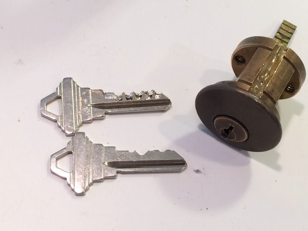

Postby teamstarlet » 18 Aug 2016 14:21
Impressioned my first Schlage KS34 with an Everest 29 core...
The blank I used for impressioning barely made it, but held on long enough to get the last few cuts...

Postby Robotnik » 18 Aug 2016 15:07
Did you manage to impression it with a nickel silver key? I'm impressed; I've never managed to successfully pull that off.

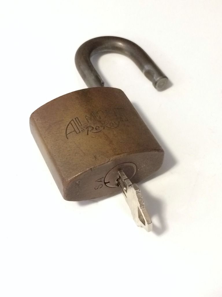

Robotnik wrote:Image
Knocked a little rust off my impressioning game today with this Almont (5 pin SC1 core).
I'd forgotten about the Almont rekeyable padlocks. I played with my share - rekeying them, that is - back about 20 years ago, but for the life of me, aside from the little wire that enables you to remove the plug, can't remember the mechanics of it. I'll have to go find my old ones somewhere and get back in practice.

Postby jeffmoss26 » 20 Aug 2016 11:55
teamstarlet wrote:Impressioned my first Schlage KS34 with an Everest 29 core...
THANK YOU! You are a legend. This lock belongs to a member of my locksport group, several of us tried to pick it unsuccessfully. I then sent it to Nite Owl who gave it to you to impression. I owe you one :)

Postby teamstarlet » 30 Aug 2016 13:18
Robotnik wrote:Did you manage to impression it with a nickel silver key? I'm impressed; I've never managed to successfully pull that off.
I'm not actually sure what the blanks were, but they look to be original Schlage.
jeffmoss26 wrote:THANK YOU! You are a legend. This lock belongs to a member of my locksport group, several of us tried to pick it unsuccessfully. I then sent it to Nite Owl who gave it to you to impression. I owe you one :)
No worries at all! Was a great little project.

Postby jeffmoss26 » 30 Aug 2016 19:00
They are original Schlage - nobody makes aftermarket blanks for these, they are in patent until 2029 :)
